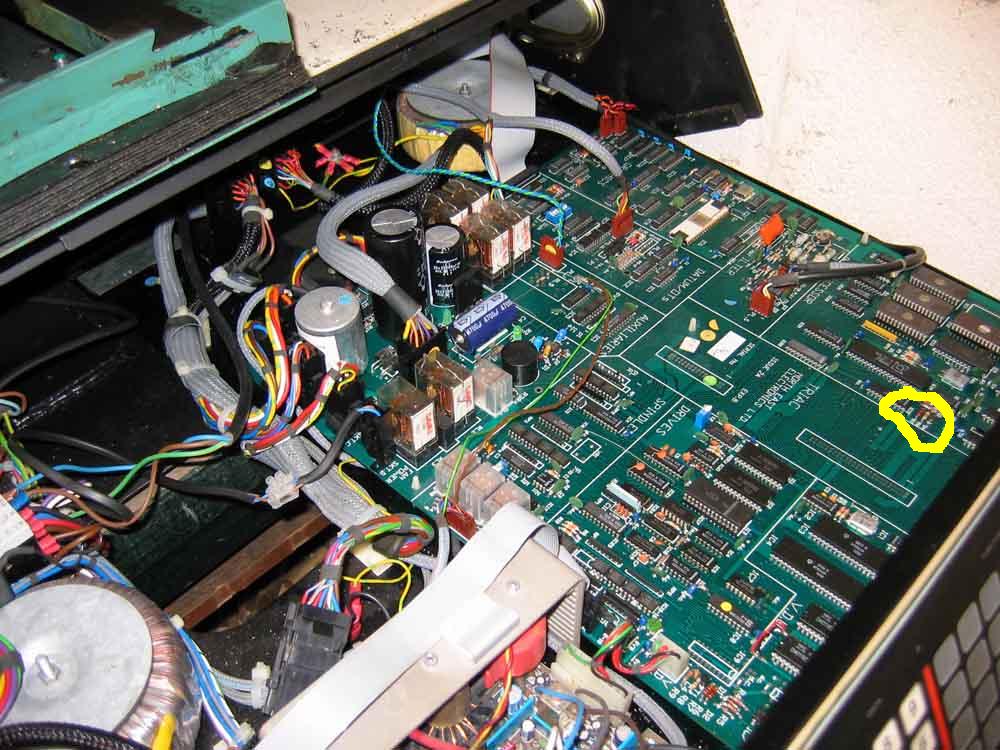

need some help i bought one of these off ebay and the main board has three blown res. two one the proc. one one the filter i would like to buy a new board from someone one here or just get the values so i can try and repair it let me know

i will get pics and the ser. number later today but i put some power to it and the machine spindle goes real slow in rev without me doing anything i have to leave the emerg.stop button out in the run position then turn om the power the monitors do nothing the small one has a black wire and a spring that is just laying on the bottom of the case. that screen foes nothing at all , the other monitor show green lines buut thats it i cant read anything ,the spindle goes really slow in rev. and none of the axis will move and you can not stop the spindle with any buttons.i had a dyna mill that i could hook a tv up to using the video in rca jack will that work with this as well sounds like the board is crapped out i hope thats all that is wrong with this

here is a pic of the board the yellow is where the res. are burnt out
Post by Steve » Sun 19 Aug , 2007 15:10 pm
The electronics you have are made by North East Electronics. Unfortunatley they are very old and now unsupported. :cry: Several people on the forum have replaced these and fitted Mach 3. There are several threads telling you how to do this.

well i found a guy that will sell me a new mother board for 100.00 us money do you think this will fix the problem? i would not mind converting the system over to use the mach 3 but i have no idea what to buy or how to do it i did try and replace the resisters that were burnt out but it did not help and im not 100% sure i got the right ones in there but i figured it could'nt hurt to do it it doesnt work now .not sure why i have no video through the spring with the black wire sodered to it might be whats wrong but i dont know where that goes
