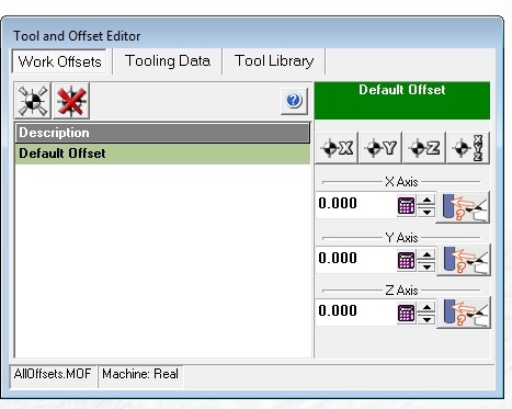

I use VR Milling 5.
When transferring the machine's X, Y and Z coordinates to the work offsets menu the default is to transfer the coordinates without changing them, so in the case of X and Y the work offsets will be aligned with the CENTRE of the cutter. The boxes to tick are along the top right of the window. The G Code then allows for this either by using cutter compensation or by changing the X and Y positions, within the G Code, by half the diameter of the cutter. When importing DWG files into VR Milling to produce G Code, I've never seen it use cutter compensation. It always modifies the cutter path.
I haven't tried using the option of aligning the side of the cutter with the edge of the work and then clicking the box to modify the coordinates by adding (or is it subtracting?) half the cutter diameter. The boxes to tick are down the right side of the menu. Have you tried noting the machine's X and Y coordinates before you transfer them to the work offsets menu? If things are working OK you should see that the coordinates in the work offsets menu differ from the machine coordinates by half the cutter diameter or 2.5mm in your case.

Thanks for that, I have been clicking in the boxes on the right which has only offered inboard or outboard of material, I didn't realise the default was to set to the cutter centre. I'll have a better look at this now next week. With the old V2 having the 3 to select from on the same window I figured it had been changed to only in/out board for some reason.
I thought it was odd and half expected it was a SUE Fault (Stupid User Error) in my abilities.
