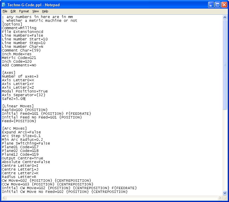

I was wondering if it is possible to modify the post files "parameters" in QuickCAM3D. For example, when I create the NCD file using QuickCAM3D and open the NCD files for my Formula One car, the Z value keeps sending my motor/bit too high on the Z axis, hitting a limit switch. I usually have to modify the NCD file (set the Z to 0.0000 rather than Z=0.1969). Is this possible? I have a Techno Isel Davinci stepper motor mill. Thanks.
Alter default safe height in Denford post processor files
Customer question:
Re: Alter default safe height in Denford post processor files
Yes it's possible.
Locate the appropriate post file, usually in this directory:
C:\Documents and Settings\All Users\Application Data\Denford\Posts
(You may need to turn on hidden files/folders to see it)
In this case, the file will be Techno-G-Code.ppl (nb the filename is exactly the same as it appears in the software)
Open the file in a basic text editor like Notepad
Look down the file for Safe2=5.08
Safe2 is the safe height position for the Z axis (ie 0=X 1=Y 2=Z)
The post setting file is fairly easy to work out, and there is also a file called posthelp.txt which explains some of the features should you wish to make your own post file...

- postfilenotepad.gif (19.32 KiB) Viewed 36242 times

Thanks for that, I checked the z position across the 25mm sacrificial board and there is a discrepancy! must be because the cut surface of the MDF has alowed the atmospheric moisture to enter from that side.
I have been into the post file and altered the Safe2 from 5.08 to 10mm and saved. However now I have come to do a test run the macxhine says that the z axis is in motion when I try to home the axes and it's definately not in motion - the z axis displays right up through 1000mm!
Is this likeley to be related to me fiddling with the safe height or is it another fault and pureley coincidental?

Sounds like something else.
altering the z height only changes the numbers in the nc programme.
hopefully a reboot of everything has fixed it?

We have identified the issue with the Z axis not physically moving, it turned out to be a loose pulley wheel on the drive screw..tightened the grub screw and all sorted!
That's great, I have seen that before on a vertical router...short rapid moves will cause the shaft to slip in the clamp if it's not tightened properly.
Maybe you should lock the grub screw in place with some thread lock (Loctite) and/or another screw on top of it.
