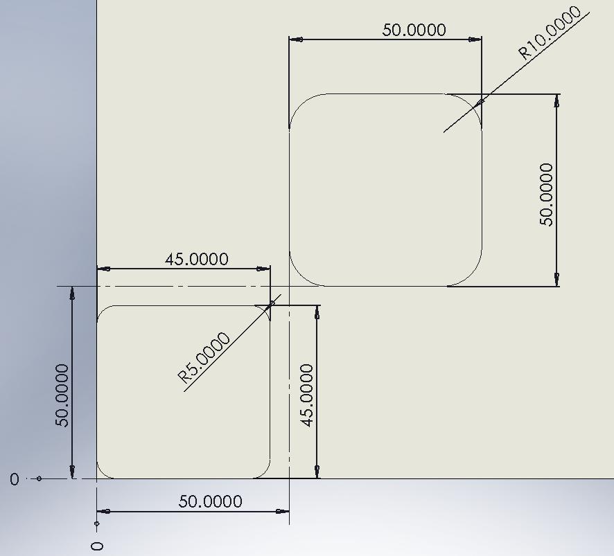

Example Program (see dimensioned drawing of the two boxes)

The two boxes produced by the example program.
