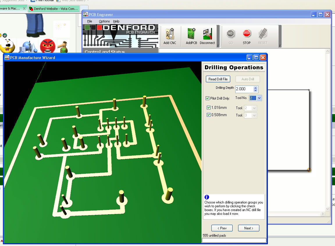

Instead of reading a drill file, try outputting the gerber with un-filled pads where you want to drill.
The software recognises these and will automatically pick out the drill sizes required.
(See attached)
(See attached)
- un-filled-pads.jpg (152.99 KiB) Viewed 30134 times

Thanks, that would be the easiest way, but the Eagle CAM processor "Fill Pads" box is permanently checked, and greyed out.

Re: Eagle PCB software - Gerber output setup files
According to the Eagle forum there is no way to produce Gerber data with unfilled pads.
If you can edit the gerber output post, it should be possible to define the "flash" shapes for pads ?
Its a while since I looked at the Gerber file format, but as I remember, pads and tracks are created with basic brush shapes (like potato stamps) called apertures.
They either "flash" a shape into one place (to create a pad for example), or place it and drag it along (to create a track with rounded edges)
The shape of these "stamps" is defined at the top of the gerber file and can contain holes in the middle.
If you can modify the post, then it'll be worth looking this up...
Thanks, that does make sense. I now remember reading that "doughnut" shapes were used to draw lines, so it must be possible to define them. Maybe I couldn't have unfilled pads because I was using an auto generated wheel file. I have also discovered an Eagle user language program that generates Gcode directly, which I think is what your engraver uses. Last PCB I made worked well, I think the comment about having to drill from the top and mill from the bottom was just my mistake. Onwards and upwards!
