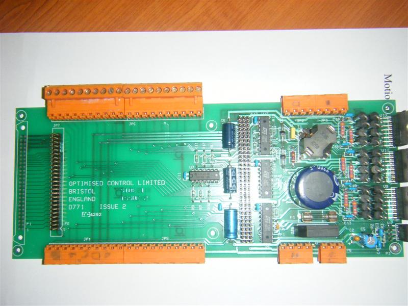

Unshure of its age but the main circit board was produced by:
OPTIMISED CONTROL LIMITED
BRISTOL
D771 ISSUE 2
4202
The previouse owner decided to take all the wires out to convert it to mac i have identified the stepper motors but i want to get the speed controll working i am in county Cleveland

Could you take a photo of the electrical panel?

The board you have is earlier than anything I have drawings for.
I suspect it would be a very basic circuit.
I attach a diagram for a smart step which was the following generation machine.
