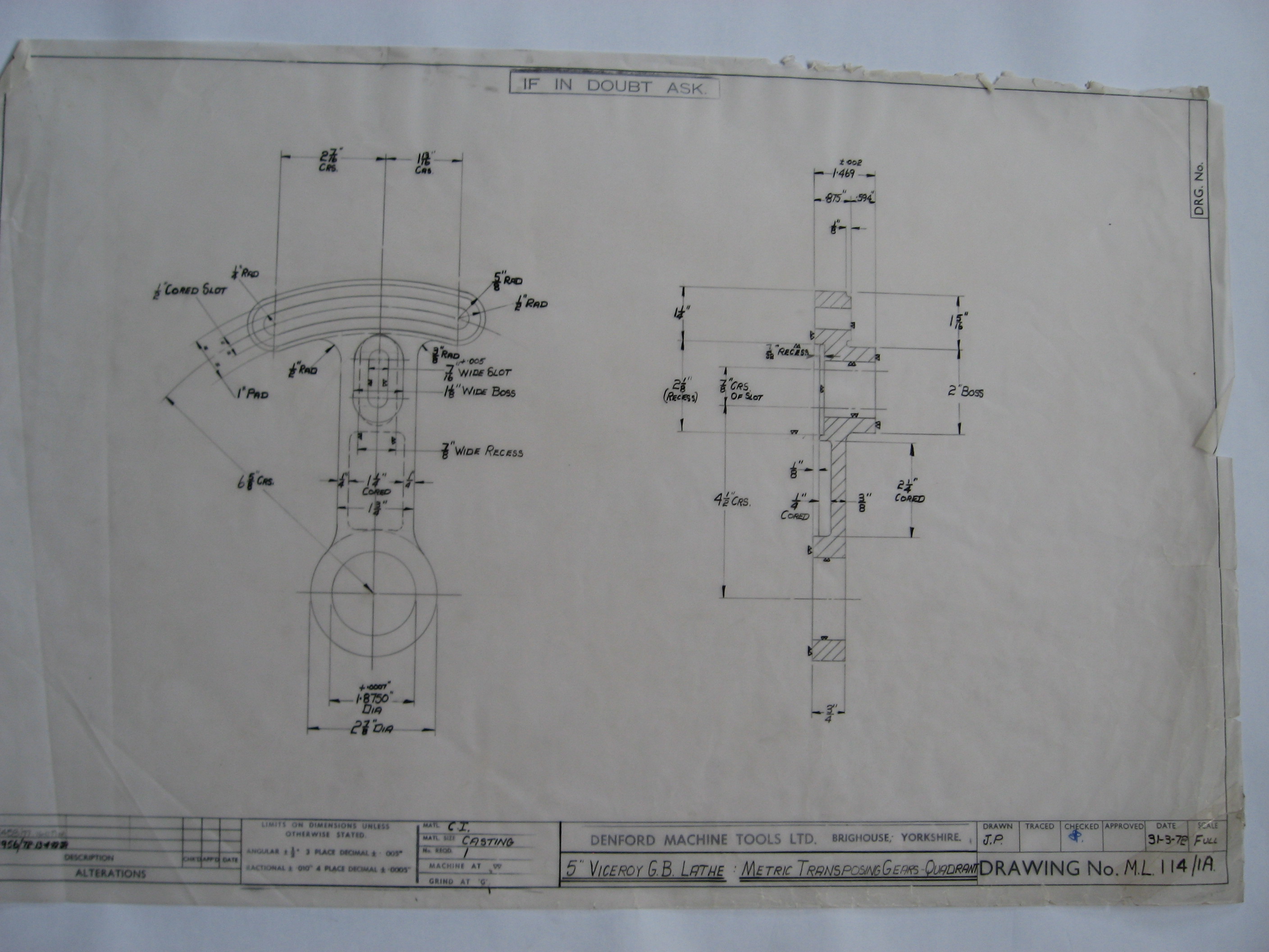

Next, the quadrant - machined casting
ML114/1A - Transposing Gear Quadrant
ML114-1A Transposing gears quadrant.jpg (1 MiB) Viewed 18754 times

thanks andy!!!!!! can some one get the rest put up andy/admin? plz And were can i get a Quadrant from or can i just use the metric one i have got?
Andy B
Posts: 396
Location: East Midlands, UK
Post by Andy B » Fri 28 Nov , 2008 10:06 am
Quadrants are about as rare as rocking horse droppings!
But there was one on ebay yesterday (not sure when it ends)

HI i was biding on it but its going to go mad like ebay is! over priced nut's on there. pay silly money! admin theres not one sitting about denford ? or can you still get them cast for me off whoever is doing your casting now? I will pay for it if you get me a price!!! plz + I think denford making all the old parts for the viceroy will make allot of money + its support us!! boxford and myford still do it ? thanks graham
Post by Denford Admin » Fri 28 Nov , 2008 14:56 pm
Sorry - we've no patterns left from those days. Any spares like that were sold of in a job lot a few years ago (possibly to the guy on ebay ?!)
What kind of money are you talking ?
As getting new castings would be very expensive, wouldn't a bit of fabrication and milling do the trick ?
graham4877
Posts: 47
Joined: Mon 10 Nov , 2008 10:30 am
Location: newcastle uk
Post by graham4877 » Fri 28 Nov , 2008 15:34 pm
Well i was think when i am back at work next week getting it burnt out on profile burner! then milling it down or make the step and fixing it on by pins or weld it then mill/turn it to shape ? but i need a full scale drawing photo copy so i can give it to the burner then he can do it! As i am sh#t at drawing! and a little printer at home! how much off you admin/denford ? and for a casting it will be better to have one but its all about cash how much do you think it will cost ? + will denford not get some bits and bobs cast off the old tds? its more money for you's!! thanks graham
Post by Denford Admin » Fri 28 Nov , 2008 15:50 pm
The problem lies with the investment in new patterns - its just too much unless you can guarantee being able to sell enough to make the costs back. Shame though - if the patterns did still exist, they'd only cost a few quid each before machining !
I wonder if some CAD whizz on this forum would be willing to sketch the quadrant up for you ?
