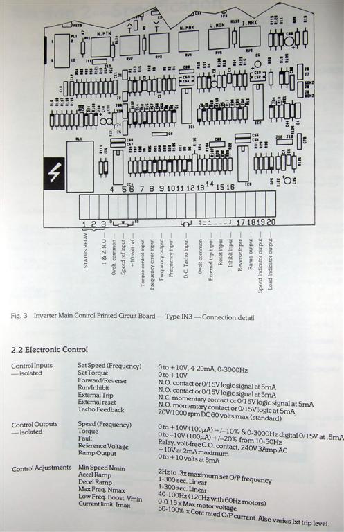

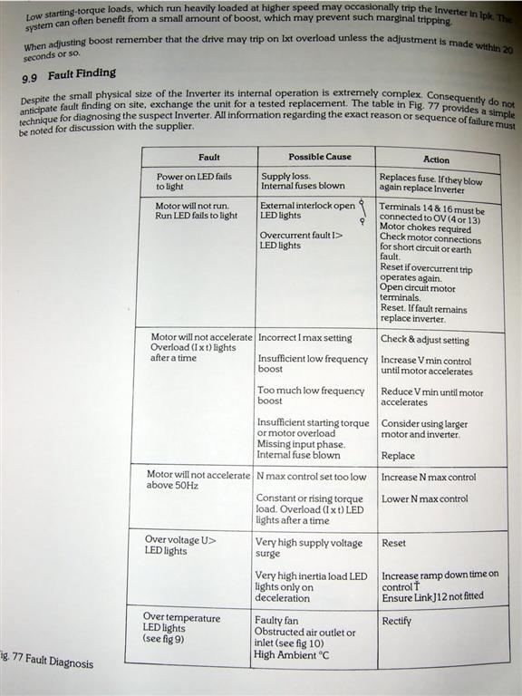

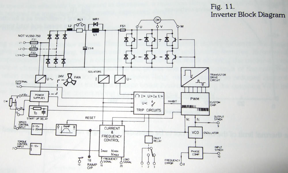

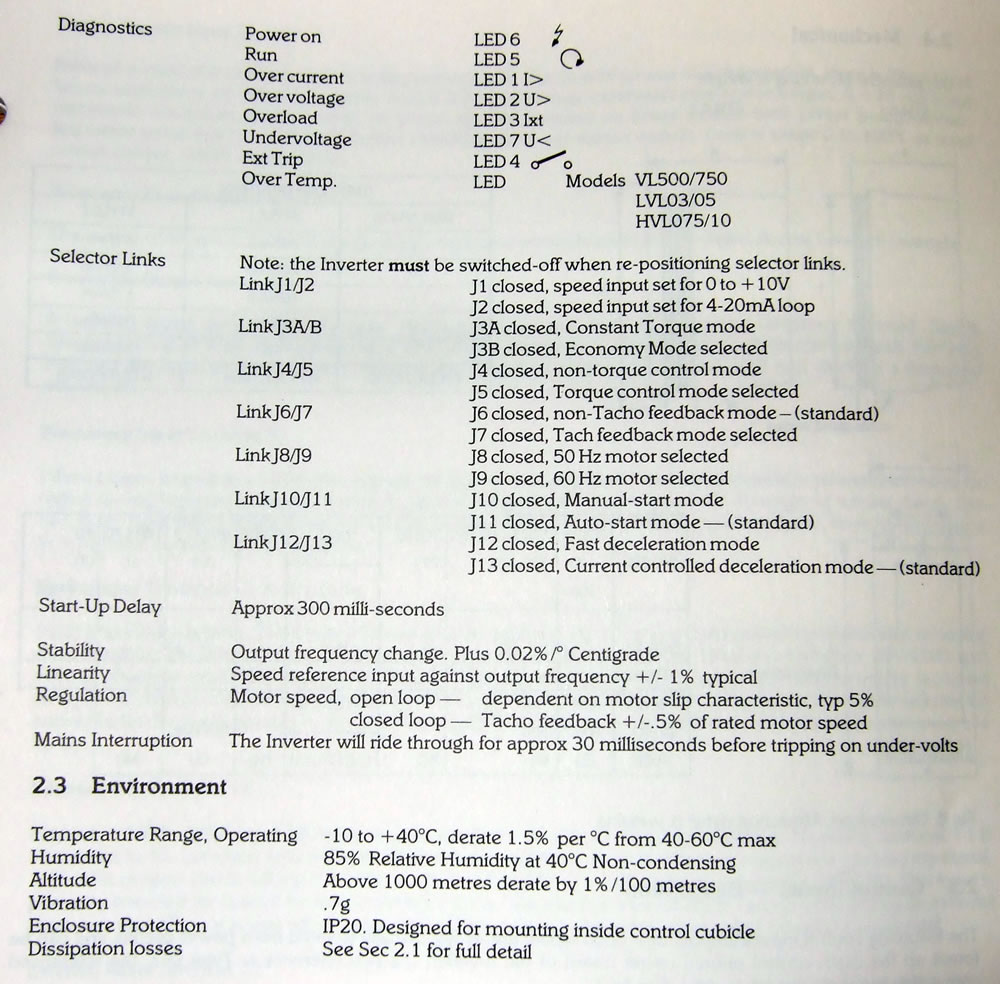

Here are some photos from the IMO Jaguar Manual.
Sorry its not the whole thing - I just don't have the time to scan it all.
Post by Denford Admin » Mon 02 Apr , 2007 13:29 pm
IMO Jaguar useful pictures from the manual.

The Inverter block diagram
Fault Finding table
LED Diagnostics
Jaguar Connections
