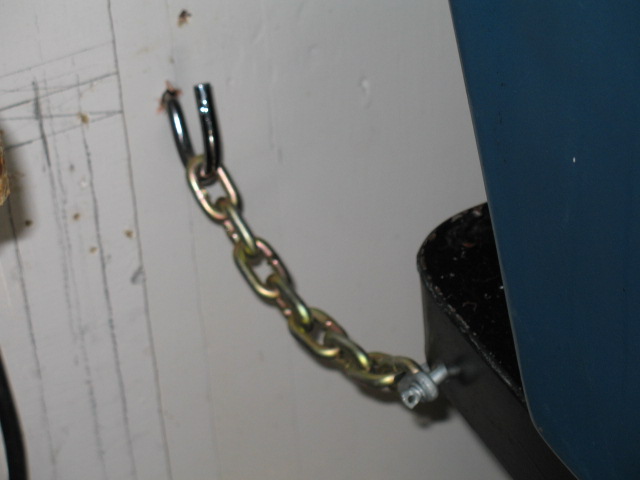

New Zealand is one of those places where earthquakes are a routine event. You can view details of the latest quake here:
https://www.geonet.org.nz/latest.html
For this reason, I have attached the lathe to the wall to prevent it dancing around or falling over in a big shake. I drilled holes at each end of the tray and fitted chains as shown.
I could have bolted the lathe to the floor, but that would have been more difficult to do.
