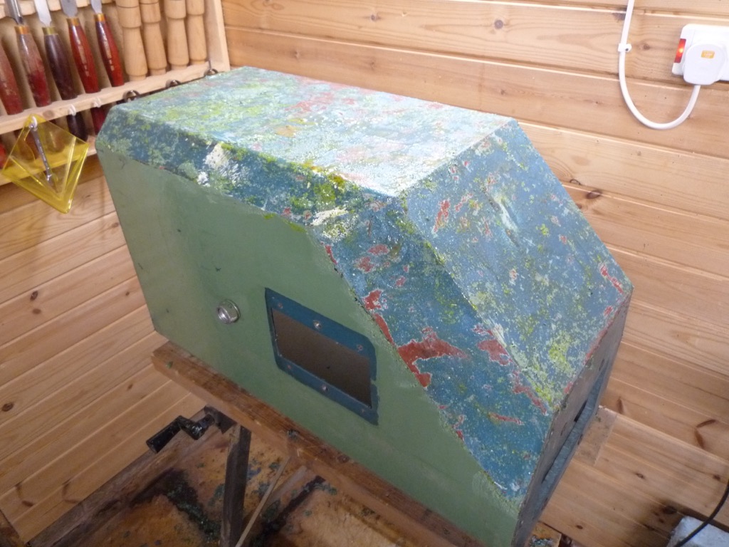

The lathe had been painted a very bright green at some point, but there were lots of paint runs and areas where the paint was chipped down to the cast iron underneath, so it needed to be stripped back completely and painted again from scratch. The motor it came with was a 3-phase 0.75hp motor, but I intended to upgrade the motor and add an inverter, so that soon came out. Pictures below of my progress so far, with comments along the way which I hope provide an insight into the process.

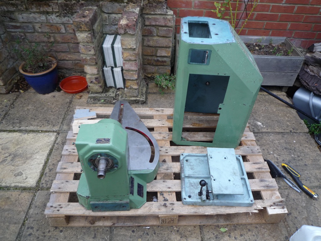

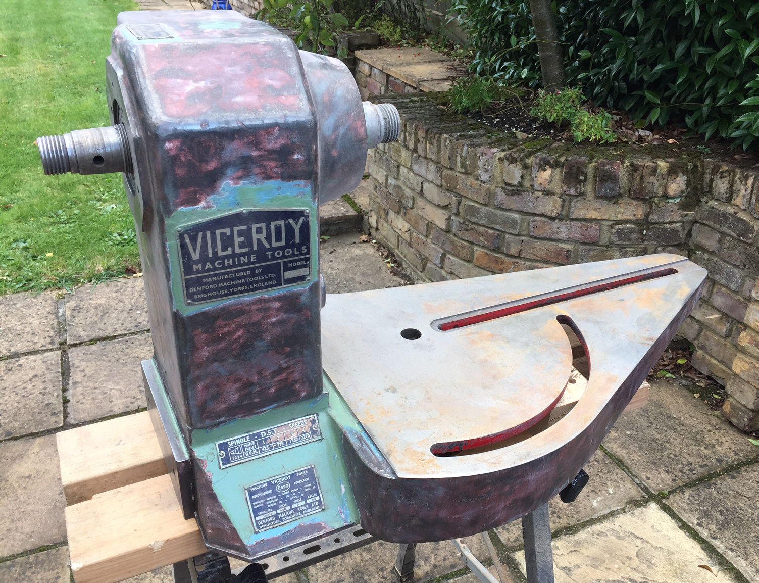

Here it is as it arrived on the pallet:

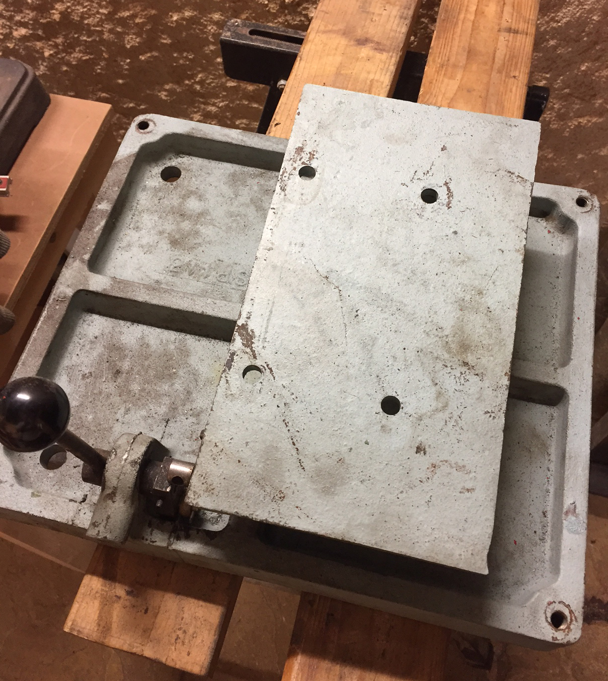

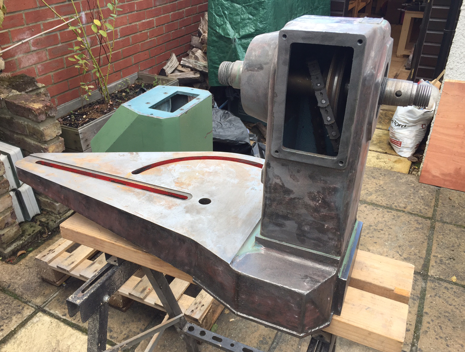

And then stripped down into the main components: headstock and base, steel base and cast iron plate for the motor:

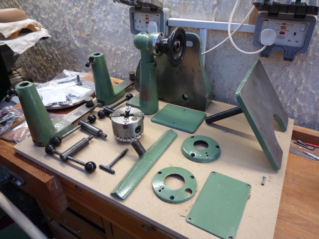

All the other components laid out on my workbench:
After a couple of hours with a grinder with a wire brush attachment, which really ripped through the paint right back to the cast iron with a little pressure:

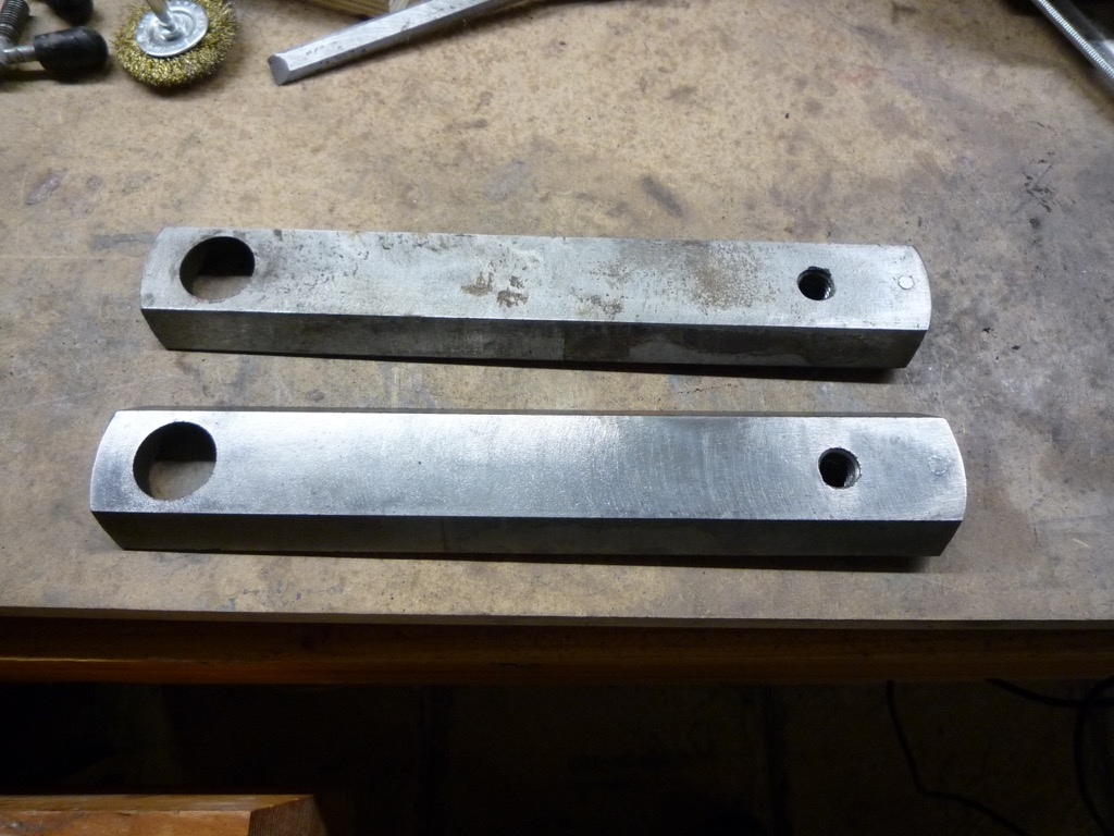

I used a "Surface Preparation Wheel" from Screwfix on the tool rest uprights and tailstock - and that whipped through the paint with very little pressure at all. This was a great tool for stripping paint off, but be careful not to apply any pressure at all!

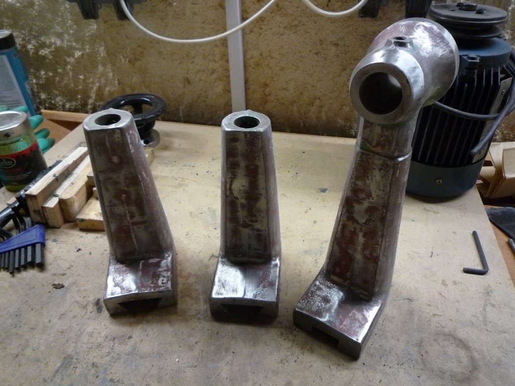

While the paint stripper was working its magic on the base, I took the angle grinder with wire brush attachment and polished the cast iron bases that the tool rest slides on. There are two of them: one before, one after:

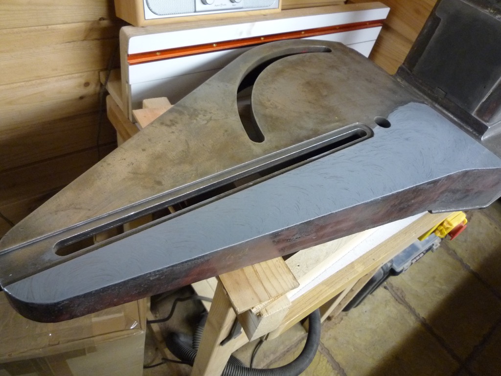

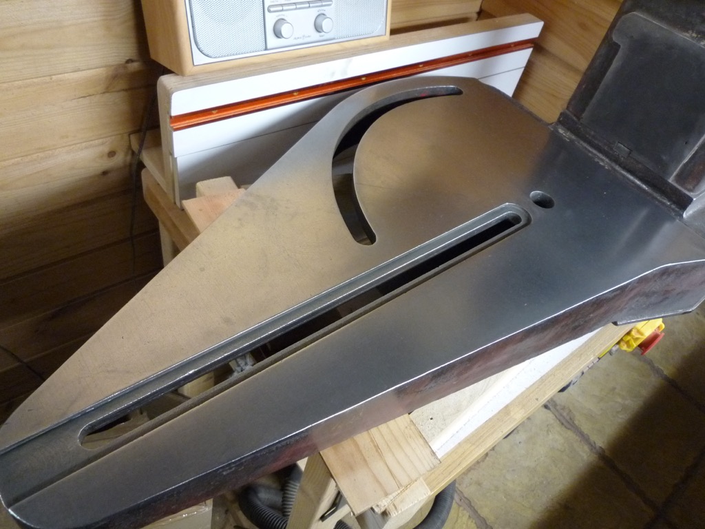

I also turned my attention to the lathe bed to remove some of the rust and marks. I used a variety of metal polishes: Autosol Bluing Remover which is designed to remove the blue heat stains from the exhausts on my motorbike, applied with 000 wire wool:
The lathe bed came up reasonably well with the Bluing Remover, but I also used Autosol metal polish, and even tried a Brillo pad with WD40 to remove some of the deep stains - however, the circular stains wouldn't clear entirely:

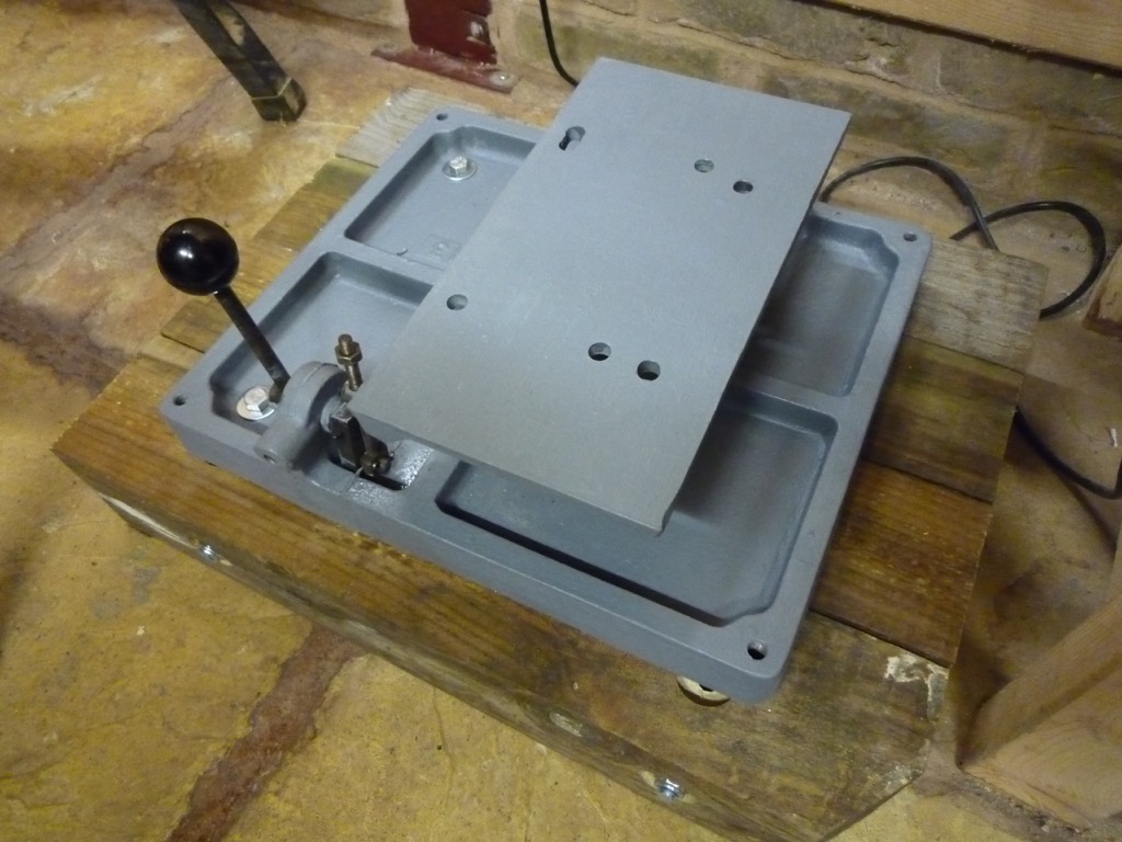

Here is the base for the motor as it arrived:

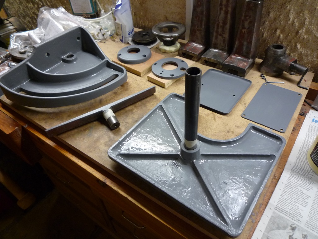

And after a couple of coats of primer, showing the new holes drilled to take the new motor, and bolted to the new base I made out of an old 10x10cm fence post, with 4 x 50cm lengths bolted together with a 10mm threaded bar. I knew the centre height of the lathe was a couple of cms lower than my previous lathe, and I wanted it to be even higher, so this seemed like a good solution to raise the centre height while also adding even more mass to the base to prevent it moving around my workshop:

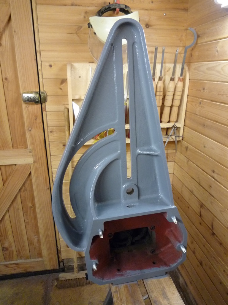

The underside of the lathe bed after 2 coats of primer:
And the other components being primered:
I'm now waiting for the primer to dry completely before I can start on the top coat. Pictures of that to follow when complete.

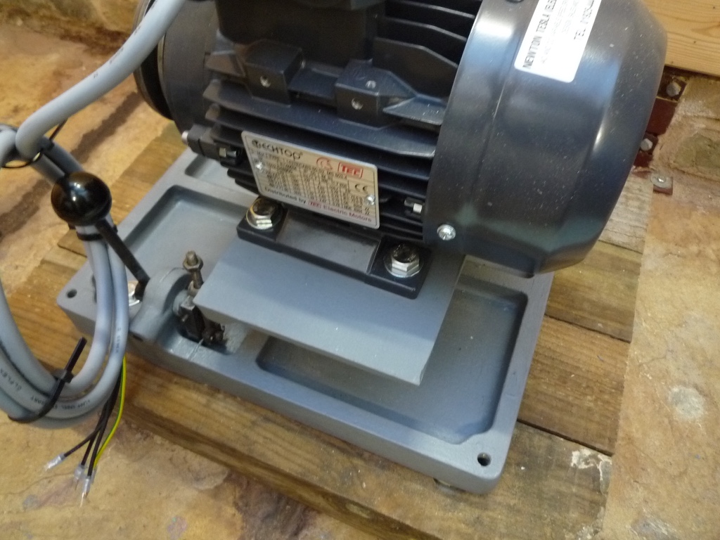

First of all I had to bolt the new motor to the base plate:

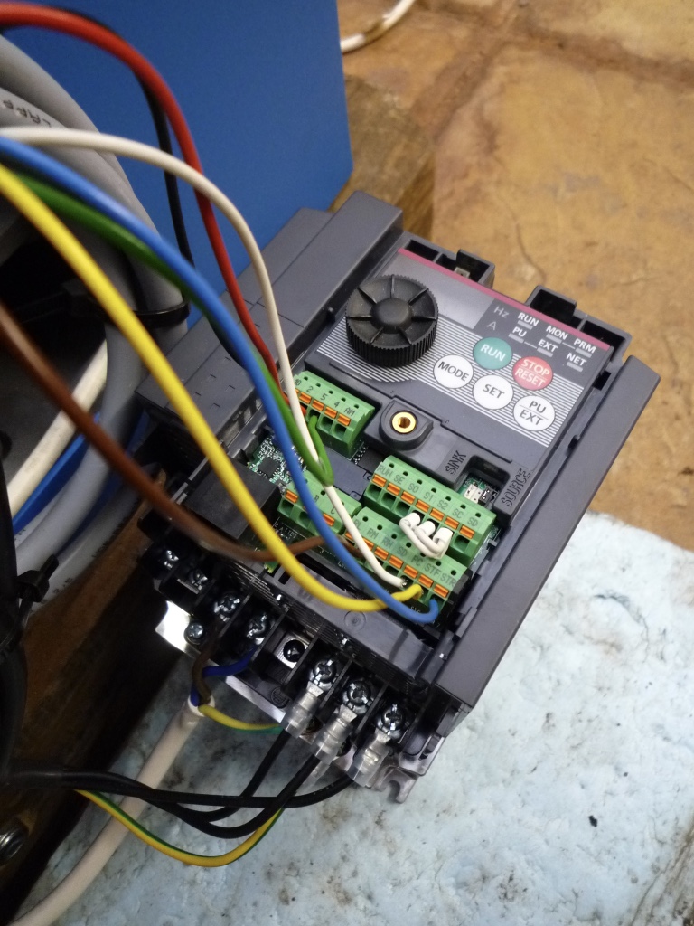

Then I connected all the wires to the inverter: the mains lead from the plug, the grey cable from the motor and the black cable with the wires from the control panel. Instructions from Newton Tesla were extremely clear and simple, very easy to follow.

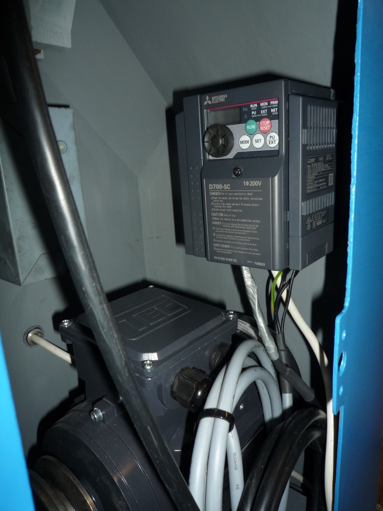

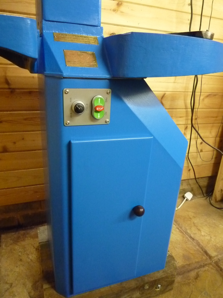

Here is the inverter installed inside the base case, with four socket head screws from the outside to nylon locking nuts on the inside.
The control panel and door now fitted.

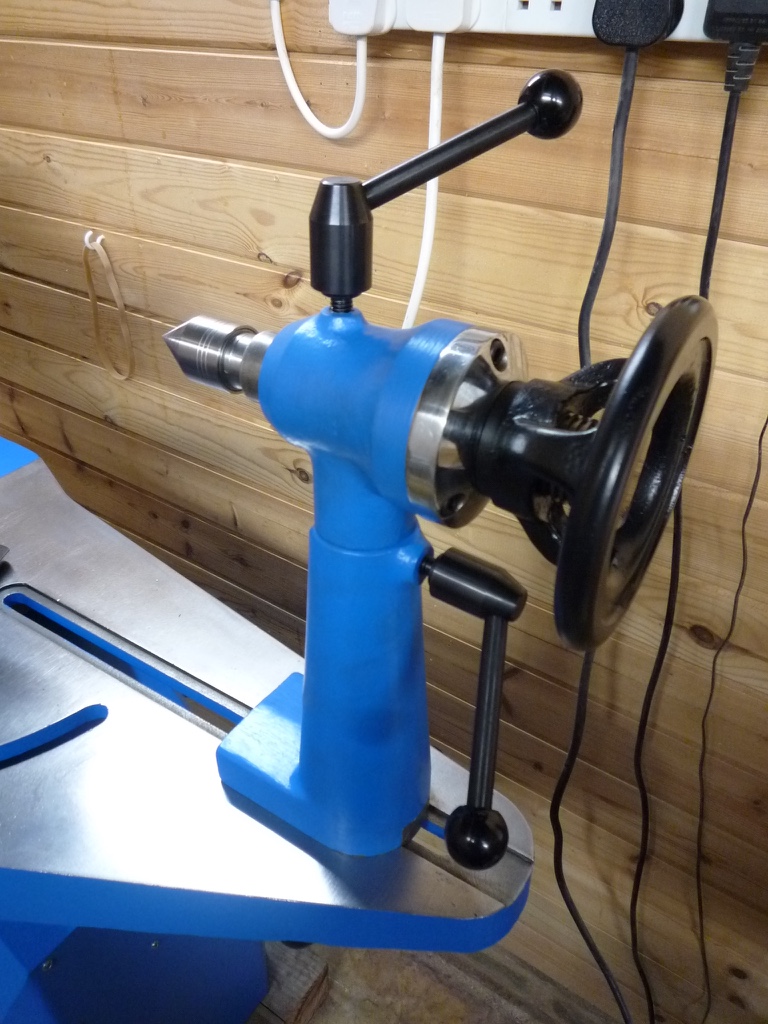

The tailstock fitted to the bed, with the original handwheel repainted, and new locking handles for the tailstock and live centre or chuck from Berger tools.

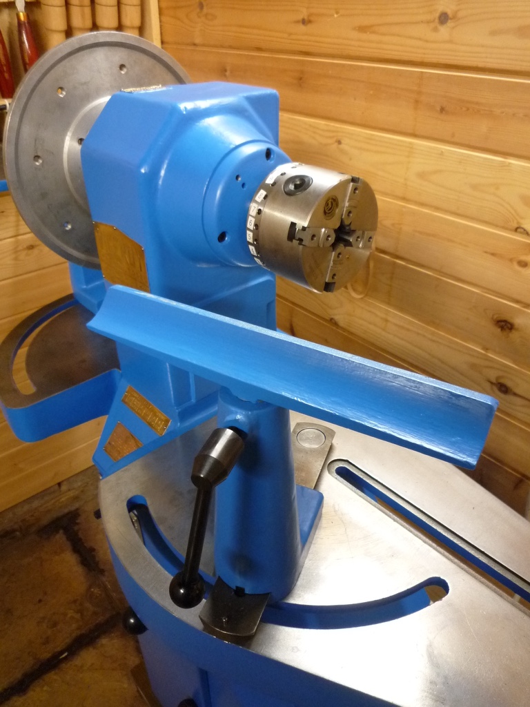

The tool rest fitted to the bed and the chuck to the spindle.

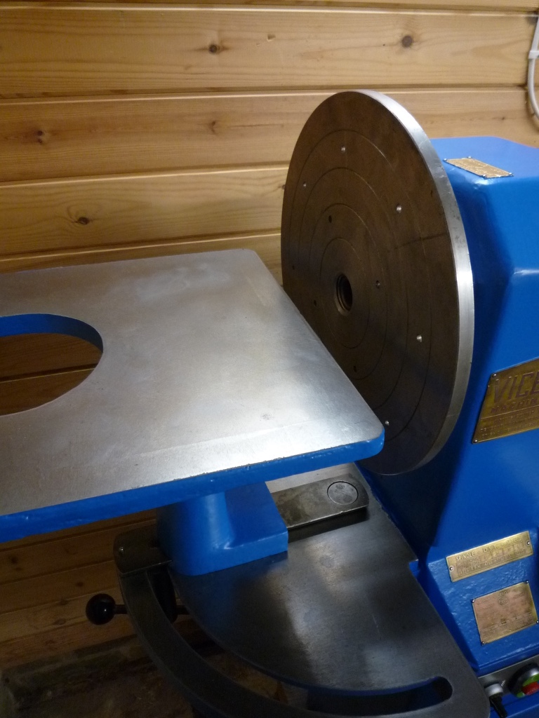

The left-hand bed installed, with the sanding table and faceplate on the LH spindle. I have a sanding disc I need to screw to the faceplate.

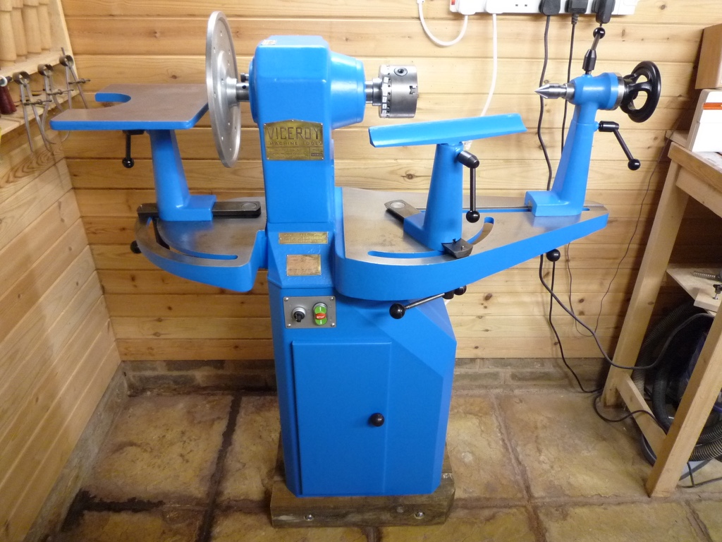

And the finished item with everything complete.
I was concerned when I was painting it that the colour was possibly actually too bright, but once it's all together, it looks just how I wanted it to - and it'll soon be covered in sawdust and wood shavings anyway. I'm going to leave it for a week to let the paint harden before I turn anything on it. In the meantime, I need to make a spindle lock to fit onto the shoulder head screw behind the LH faceplate, and also start cutting and gluing some segmented pieces to start turning some more bowls.
I thoroughly enjoyed doing it, and, considering I've never done anything like this before, I am very happy with the result. Final cost of the lathe, motor, inverter, paint, handles, less what I got for selling my old lathe, was just over £1000 - but I now have a lathe with a 1.5hp motor and a 18" capacity (maybe even 19"), as well as a separate sanding table which I can use without having to swap chucks or faceplates. As I mentioned earlier, to buy a new lathe of this power and capacity would have cost me somewhere in the region of £2500-£3000 if I'd gone for a Killinger or Wivamac lathe.

JohnPDownunder wrote:... if you could have got new Name plates it would finish it off perfectly.
The name plates are etched, so it should work to just repaint them.
This technique is used for a lot of miniature name and number plates for model railways.
I would clean with Bar keepers friend, dry, apply paint with a brush in all the hollow areas then 'squeegee' it off.
Once dry, any odd bits can be removed (gently scraped or very fine (1200+ grade) wet'n'dry).
A thin top coat of varnish would then keep the brass shiny.
edit: here is a youtube video of the process, just a bit different as he paints the plates white first (for white lettering). - https://www.youtube.com/watch?v=qfrUgT-3Zok
