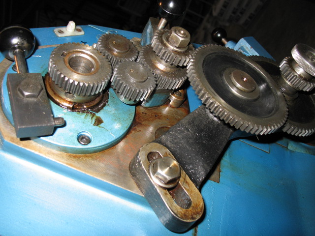

I've worked my way towards the heart of the lathe. I have removed the bearing covers, gear train and spindle bearing lock nuts.

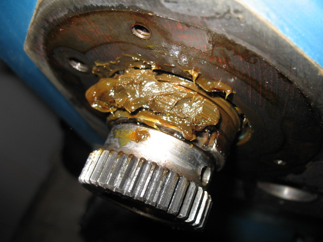

The grease has definitely deteriorated. It's dark and gungy looking. The oil is separating from the soap. It's definitely in need of replacement. There is no way I can properly clean out the bearings in situ. Too much risk of leaving, or introducing contamination into the bearings. I want to remove the spindle and bearings. Give them a good clean, grease them with fresh good stuff, and then re-install.

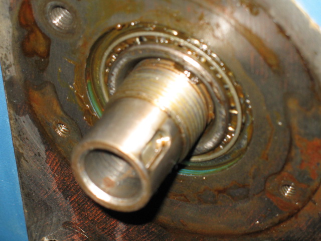

The chuck end of the spindle with cover off.

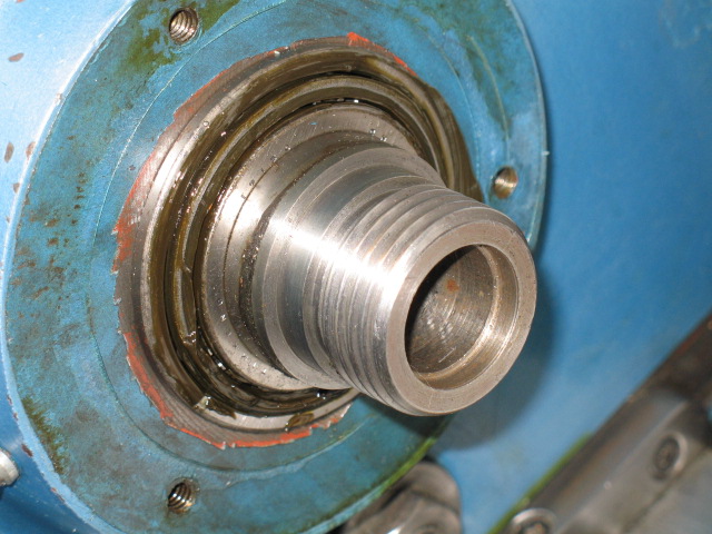

The left end of the spindle. The two left-hand threaded lock nuts have been removed.
Gear and grease covered lock nuts in place. The grease within the bearings is dark and oil is separating from the soap.
Gears on the spindle (top) and counter shaft (below) with the belt drive also visible

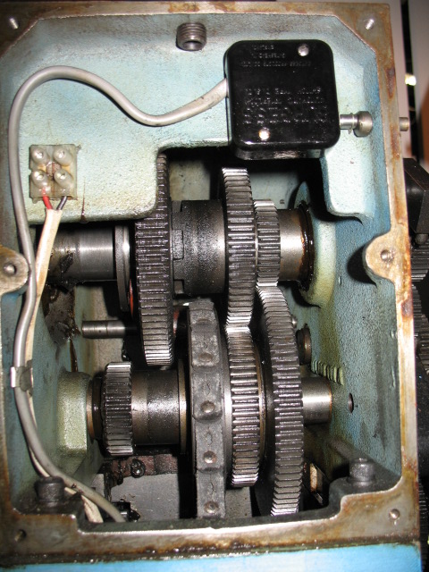

What it looked like before I took anything off.
