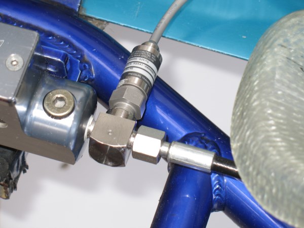

Here is a hydraulic fitting I made for my racing kart. It allows a pressure sensor to be fitted to the brake line. This data is recorded by my Aimsports Mychron 4 data logger.
The adapter has a 1/8 female NPT, 1/8 male BSPP and 1/8 male BSPT ports. A standard adapter with this combination is not available. I originally used an assembly of standard adapters but these had high points that made it almost impossible to bleed the brakes. This adapter is has an offset through hole to allow any air bubbles to rise to a high point from where they will bleed out down the line.

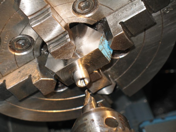

I used hex bar which made the job a lot easier than it would have been with round stock. I was able to accurately index 90 degree rotations with ease.
I started with the operation I thought most likely to fail so if that happened, I wouldn't lose much investment in time. That being the 3.5mm through hole. I had no problems drilling this.
The hexagonal stock made it easy to index the workpiece as each port was machined. Note that the hole is intentionally off centre in two directions.
IMG_2540 (600 x 450).jpg (63.28 KiB) Viewed 19757 times

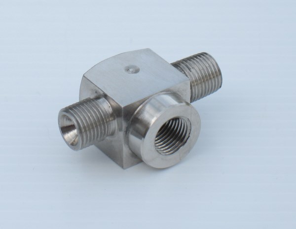

A general view of the finished adapter.
IMG_2552a (600 x 465).jpg (24.61 KiB) Viewed 19757 times

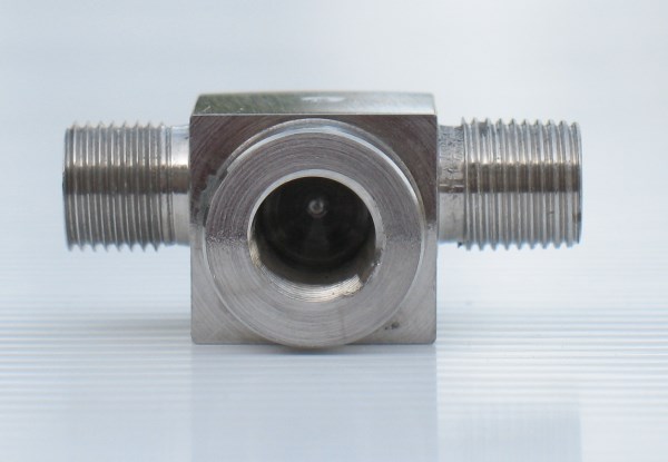

The through hole is intentionally offset to make it easier to bleed the brakes.
IMG_2550a (600 x 415).jpg (31.4 KiB) Viewed 19757 times

The hydraulic adapter fitted to the kart brake system.
IMG_2553 (600 x 450).jpg (52.39 KiB) Viewed 19757 times
