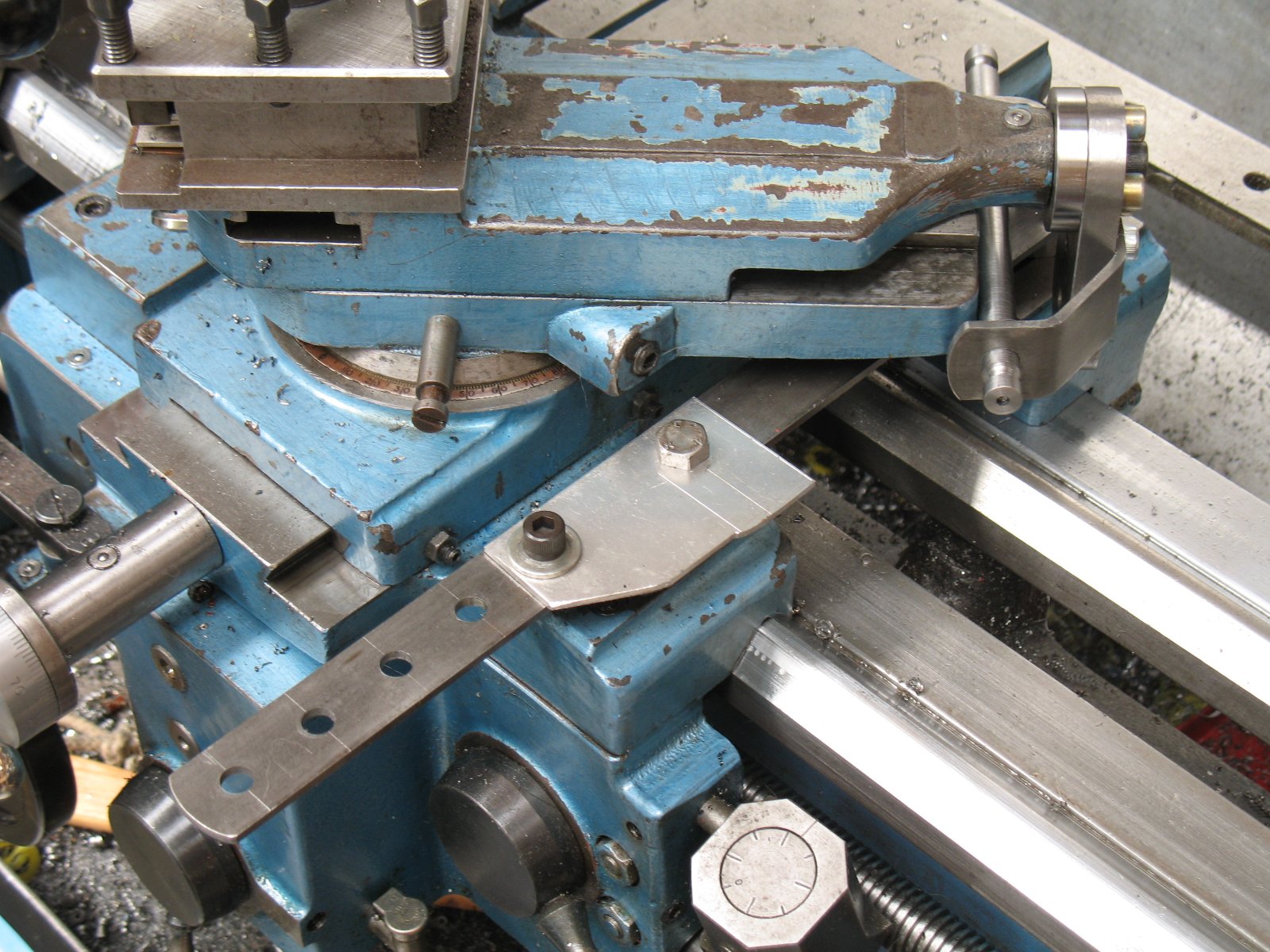

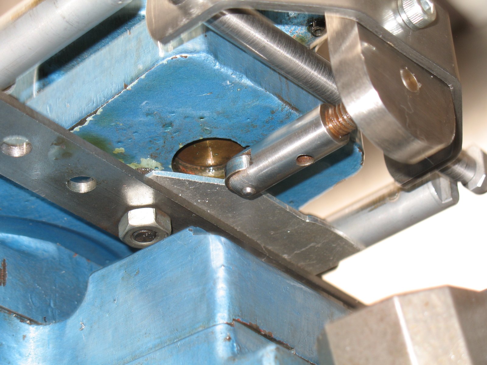

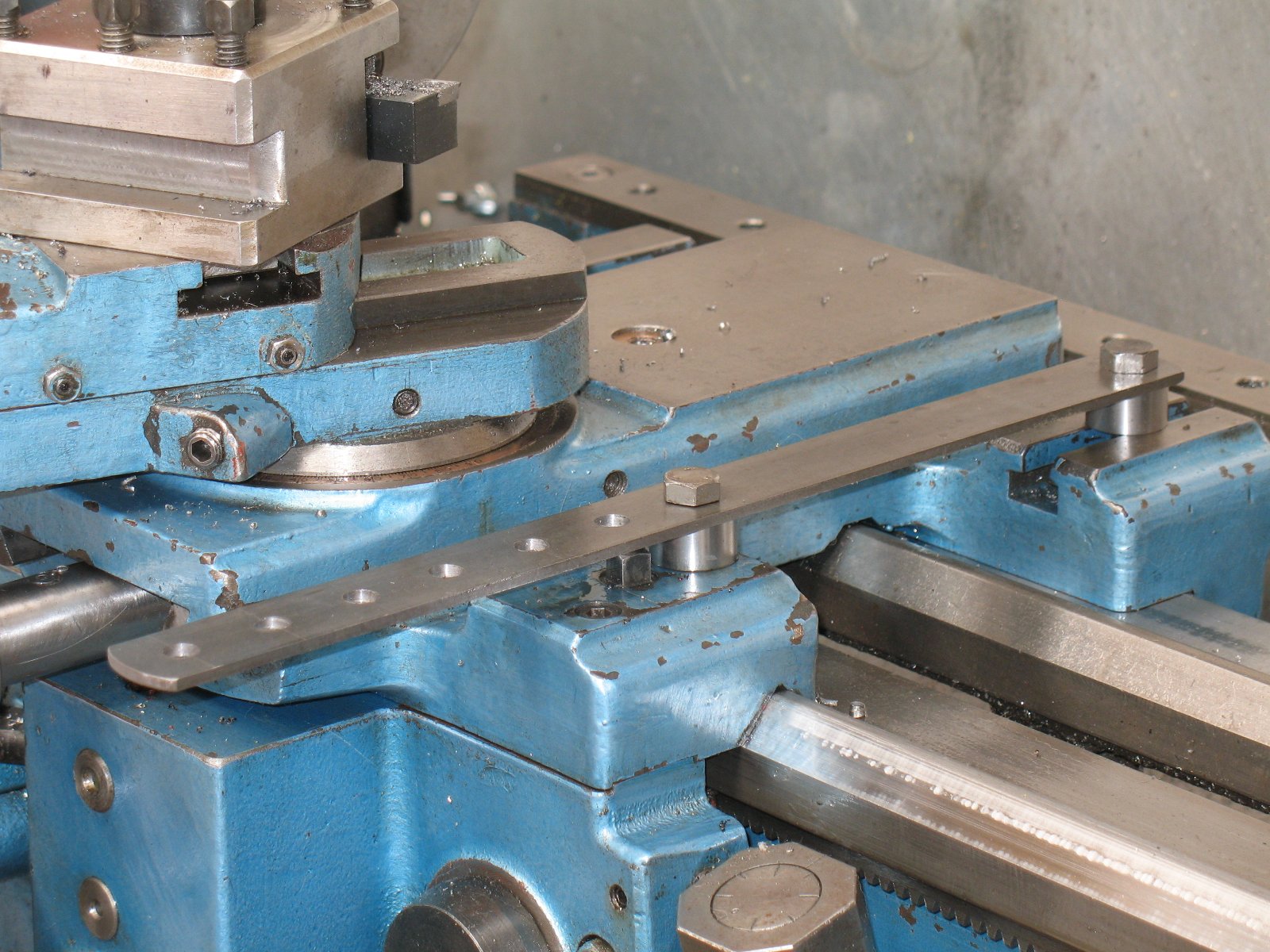

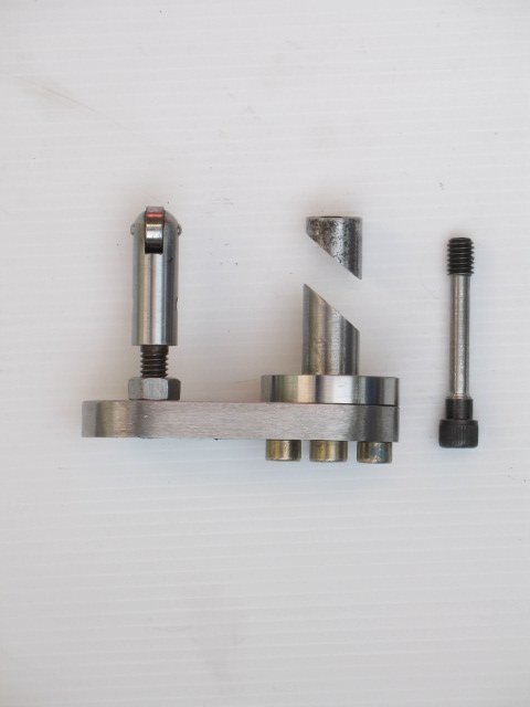

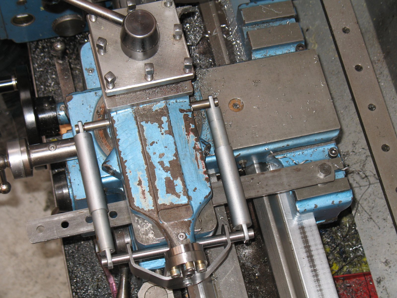

Attached are some photos that show a cross slide copier attachment. This is designed to copy the profile of a template onto the end of a bar. This is something that cannot be done with the factory copy attachment. I have used parts of the factory copier to make the cross slide version, but nothing that could not be reproduced in the home work shop.
Dazz
Shows how the bar that holds the template is fastened to the lathe.
Photo 5 template bar.jpg (348.45 KiB) Viewed 21678 times
The top slide rotated away to show a template in place.
Photo 9.jpg (357.08 KiB) Viewed 21678 times
A template is bolted to a drilled flat bar and the roller follower controls the tool path.
Photo 10 stylus following the template.jpg (281.43 KiB) Viewed 21678 times
The pieces that replace the screw and add a roller follower.
An overview of the end profile copy attachment.
