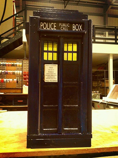

Here are the files for making a scale model of the Blue Police Phone Box from a popular BBC Science fiction program.
The majority of the parts were machined on the router using 2 tools, one was a 6.35mm end mill and the other was a 45 degree V.
The finished box is held together with panel pins and PVA.
This was a fun litle project and took about 4 hours to machine.
Photo of the finished model
Blue Box.jpg (98.29 KiB) Viewed 27895 times

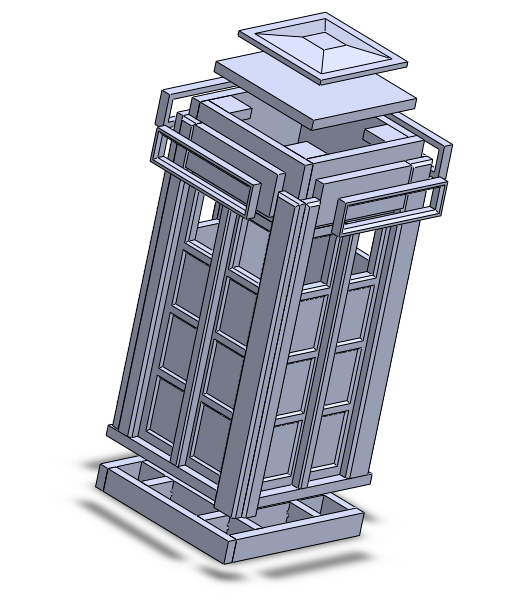

Screen shot of the Solid Works Assembly
Build Photo.png (74.23 KiB) Viewed 27896 times
