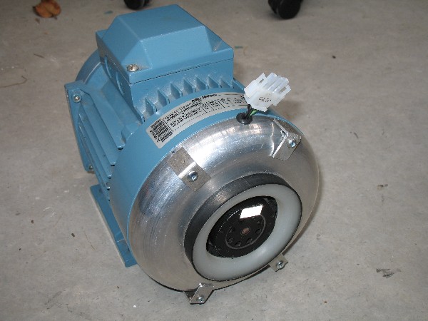

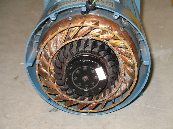

First I converted the motor. This required replacing the shaft driven cooling fan with a motor driven fan. The heat produced by a motor with VSD is the same regardless of speed. A shaft driven fan is too slow at slow speeds and soaks up a lot of power at high speeds.
I used a recycled centrifugal computer fan. This required covers to direct the air and a diffuser to prevent overloading the fan motor.

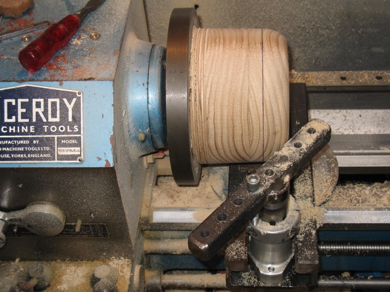

I made a hand rest to turn the wooden former and to spin the metal.

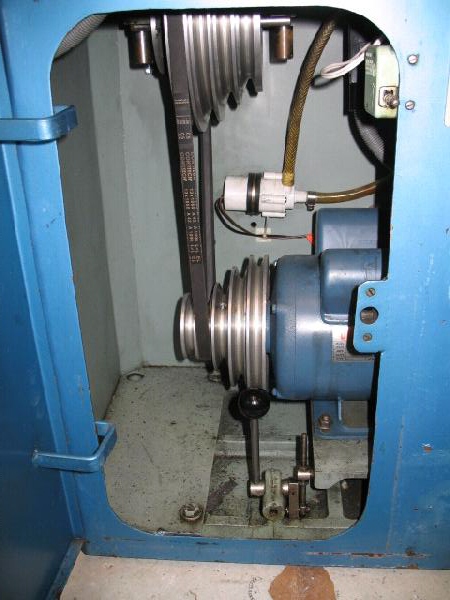

- The standard motor and pulley set. Note that the standard belt driven Denford coolant pump has been replaced with a windscreen washer pump.
- Picture 002.jpg (107.16 KiB) Viewed 58674 times

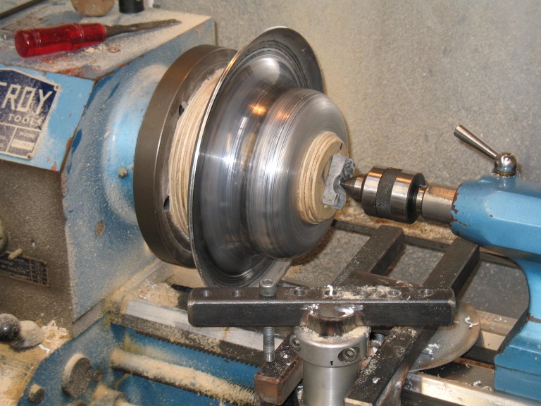

- I made a wooden form in order to metal spin the covers.
- IMG_0281 (768 x 576).jpg (135.77 KiB) Viewed 58674 times
- I spun the covers on the Denford

- Underneath the spun cover is a recycled computer fan with a copper sheet diffuser.
- IMG_0728. smlJPG.jpg (88.84 KiB) Viewed 58674 times
- The finished motor ready for a VSD. All of the modifications are reversible. The standard fan can be restored. The air intake venturi is made from a piece of 220kV cable. The copper core was removed and the insulation turned to provide a smooth air intake.

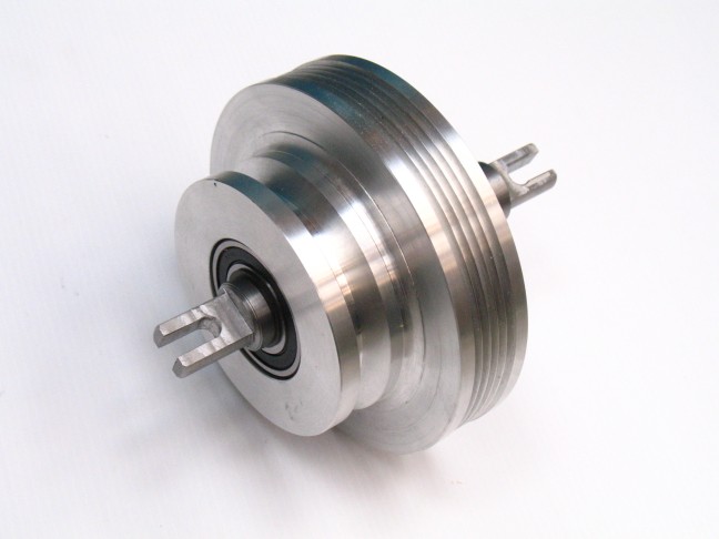

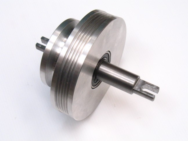

The next major part was to make the new pulleys. I an replacing the Vee pulley with a poly-vee pulley that fits on my car. Automotive belts are substantially cheaper than industrial belts.
I made both the pulley and a new jack shaft.
Dazz
Dazz
- The finished jack pulley. A Vee and poly-Vee
- IMG_1840 (648 x 486).jpg (37.51 KiB) Viewed 58673 times
- IMG_1842 (648 x 486).jpg (37.96 KiB) Viewed 58673 times
Dazz

Re: Denford Viceroy TDS VSD conversion
Metal spinning is not as easy as it looks on YouTube.
Aluminium for spinning must be one of the soft grades (100% Al is good). A random piece out of the scrap bin is unlikely to work.
Aim for a bell-shape during the spinning. The edge needs a curve to stop wrinkling. The photo above shows the edge curved back to the right. This is bad and difficult to recover from.
The spinning tool must be applied from right to left to draw the metal down over the form. Equally the tool needs to be applied from left to right to prevent the metal from thinning out to nothing.
Practice a lot.
Dazz
Practice a lot.
Dazz
Dazz
Dazz

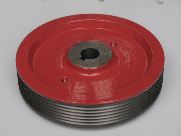

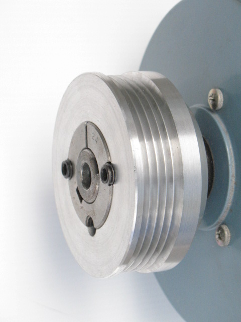

Another step closer to completing a VSD conversion.
These are photos of the motor pulley.
The motor is 1.1kW which means that it will be able to produce at least as much torque over the speed range as the standard motor.
VSDs provide constant torque regardless of speed.
This pulley is attached to the shaft with a taper lock bush.
The next step is to finish the new motor mounting arrangement. The standard one is too wobbly.
I will be replacing the cast base and motor mount with a fabricated welded base frame and motor mount.
- The motor pulley
- IMG_2162.JPG (62.86 KiB) Viewed 58175 times

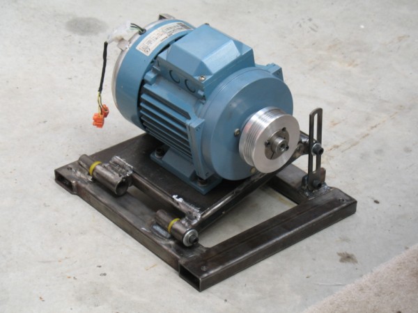

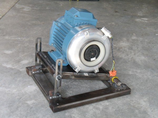

The next stage is the replacement motor mounting arrangement. The factory mount is too floppy to use with poly-Vee belts. They need the pulleys to be accurately aligned. The new mount is a bolt in replacement for the factory items.
The mount was fabricated from rectangular steel tube. It is much stronger than it needs to be but I just made use of materials on hand.
The hinged motor mount is designed to allow the motor to be extracted while still bolted down to the mounting plate.
The yellow items are nylon bushings intended to provide a firm fitting hinge that won't rattle. The hinge pins are supported at one end so that the motor mount plate can be slid off. A bolt on the end of one hinge pin stops the motor mount plate sliding off by its self.
Two height adjusters are included for extra rigidity but only one is needed.
I need to paint it while I prepare the VSD and related items for installation. I plan to fit a digital tachometer and load meter.
Dazz
Dazz
- The new motor mount
- IMG_2361 (600 x 450).jpg (58.51 KiB) Viewed 57924 times
- IMG_2355 (600 x 450).jpg (53.69 KiB) Viewed 57924 times
Dazz

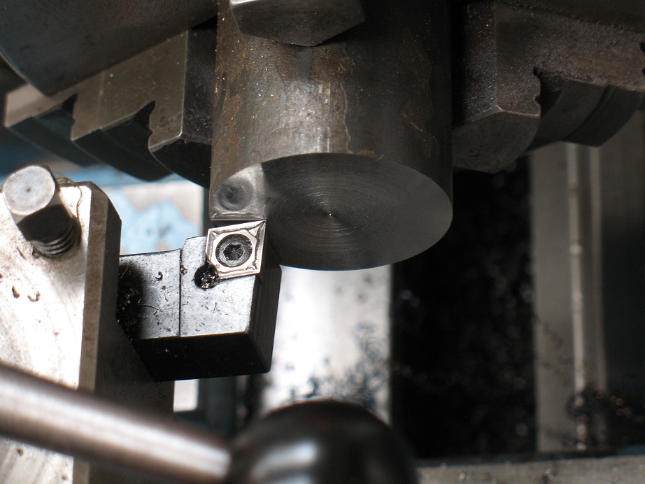

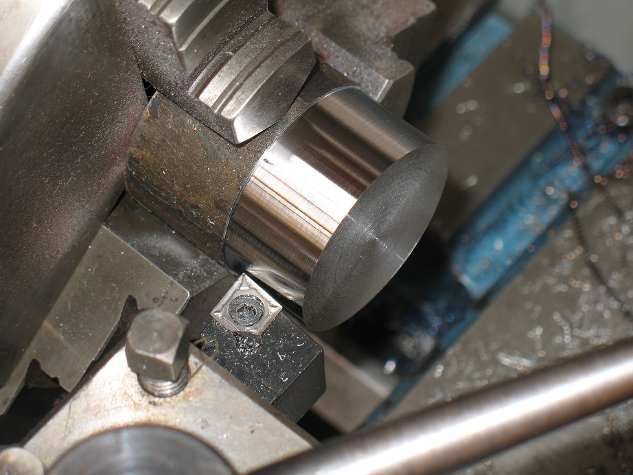

The photos show a sample of the finish achieved on my next project.
This is a manky old piece of hot rolled mild steel.
With HSS, the finish is like sandpaper on this metal.
With cermet tooling and smooth VSD, the finish is what you see.
Note the reflections of the tool on the workpiece. Not too far from a mirror finish.

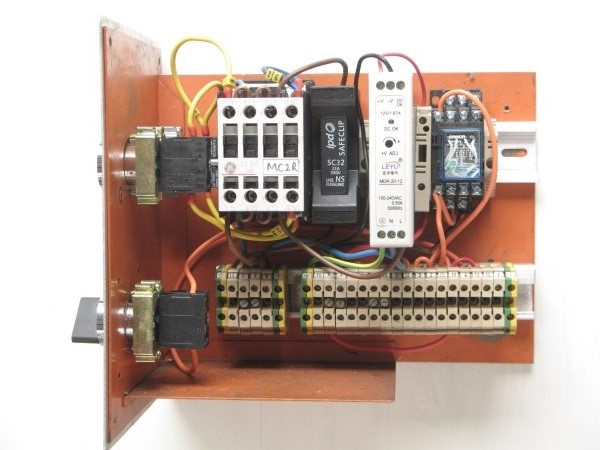

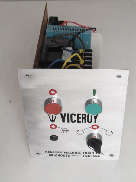

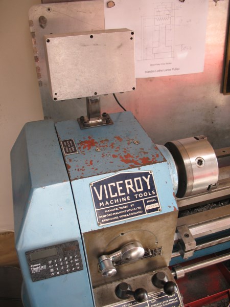

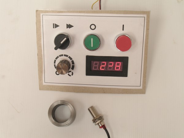

After starting over 4 years ago, I have finally completed the VSD conversion on my Denford Viceroy.
Youtube Video of Denford Viceroy fitted with VSD and new controls
- The refurbished control panel was recycled for the conversion.
- IMG_4698 (450 x 600).jpg (35.88 KiB) Viewed 55331 times
- The Denford electrical control system was completely replaced.
- IMG_4697 (600 x 450).jpg (73.4 KiB) Viewed 55331 times
Dazz
Dazz

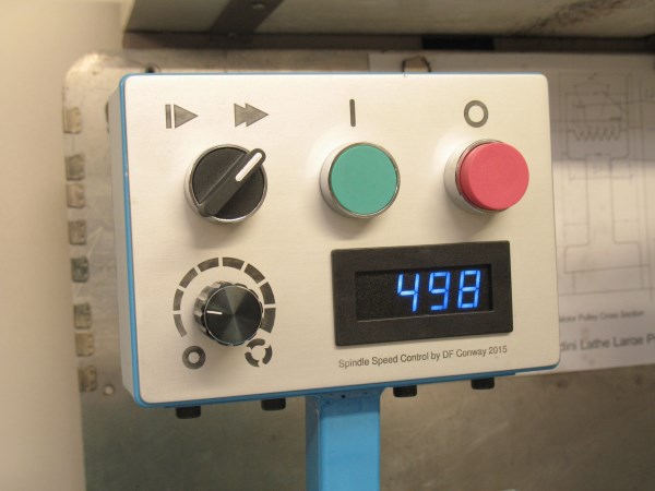

Hello

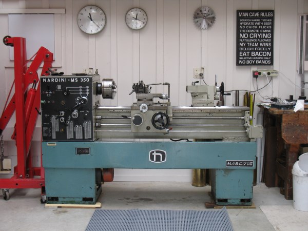

I am converting my other lathe to VSD and have fitted a 3 phase/4kW/ 220VAC motor.
It's only taken a year so far.
There is no Nardini forum on the web so I won't be posting progress on this anywhere.

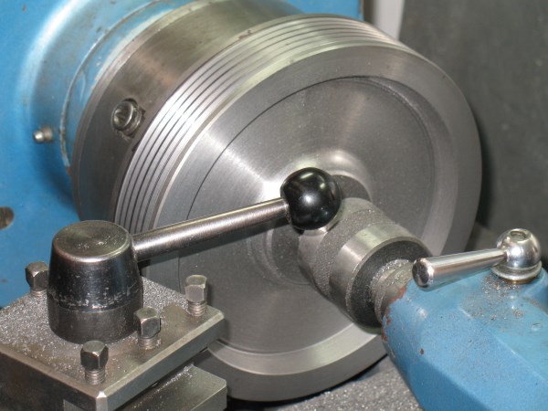

I made a poly-vee pulley on the Viceroy
- A Brazilian made lathe designed by Engineers who fled from Germany after the war.
- IMG_3856 (600 x 450).jpg (63.87 KiB) Viewed 55331 times
- The pulley had a tapered and keyed bore. I had no choice but to make it.
- IMG_4397 (600 x 450).jpg (59.31 KiB) Viewed 55331 times
- The poly-vee pulley ready to fit to the lathe.
- IMG_4590 (600 x 450).jpg (34.79 KiB) Viewed 55331 times
Dazz
Dazz,
Really nice control panel on your 3ph conversion - I assume that's a special you made.
Hello
Here is a drawing of the driver and intermediate pulleys I made for the Viceroy VSD conversion.
Note that the threaded half holes for the taper lock bush are not shown.
- Driven Intermediate Lathe Pulley.pdf
- (16.29 KiB) Downloaded 1726 times
- Driver Lathe Pulley.pdf
- (9.19 KiB) Downloaded 1647 times

- dazz
- Posts: 246
Hello
Here is a close up of the upper control panel.
I made a cardboard mock-up to test appearance and ergonomics.
The panel was mounted on a stand over the hole for lamp.
All of the cabling goes down through the inside of the headstock.
All of the VSD controls a fully remoted so there is no need to access the VSD.
That is mounted above the motor inside the cabinet.
Apart from the upper control panel, there is no external indication that a VSD is fitted.
I have tried to make it look like it could have been factory fitted.
- IMG_4644 (600 x 450).jpg (32.61 KiB) Viewed 55321 times
