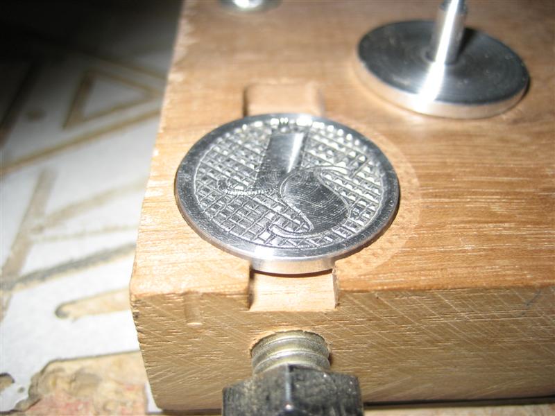

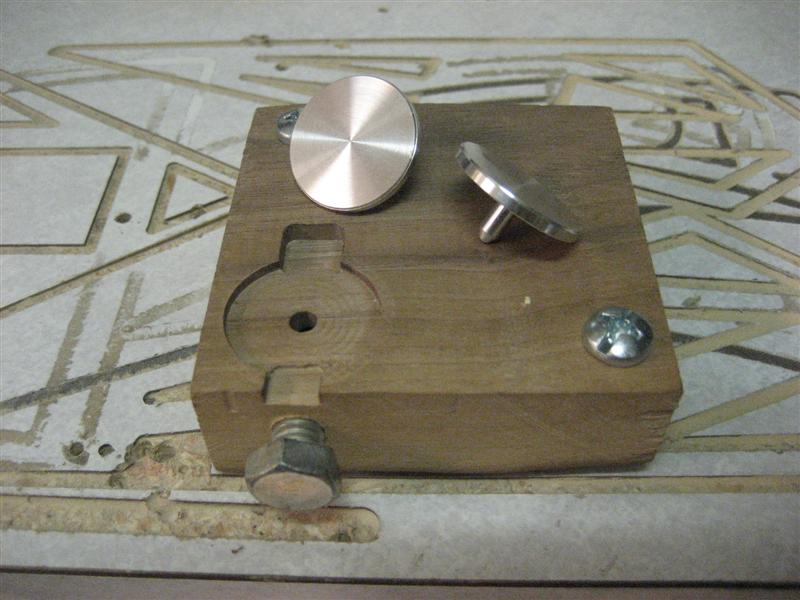

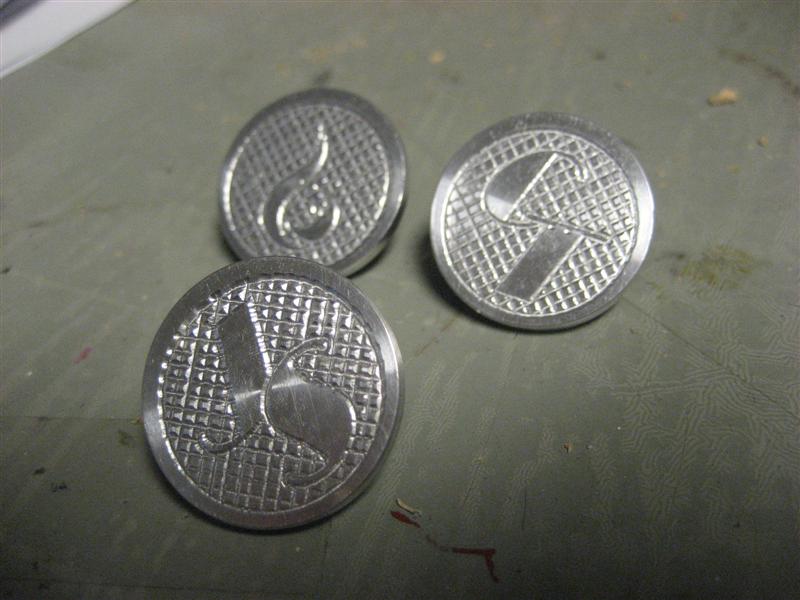

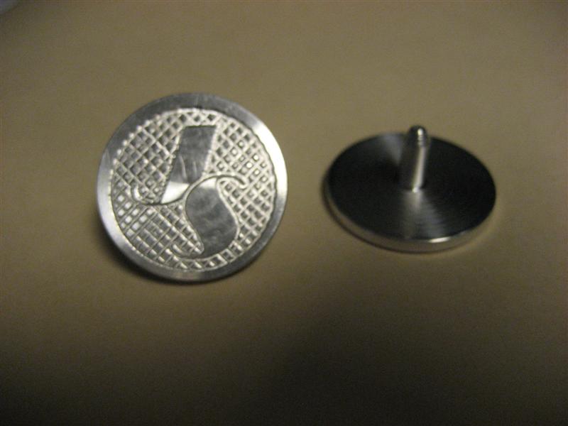

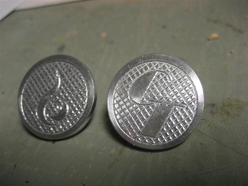

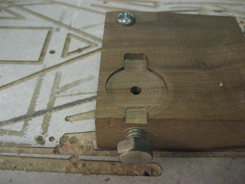

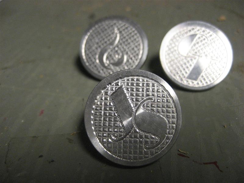

Here is a simple project using both a lathe and a router with metal cutting capability.

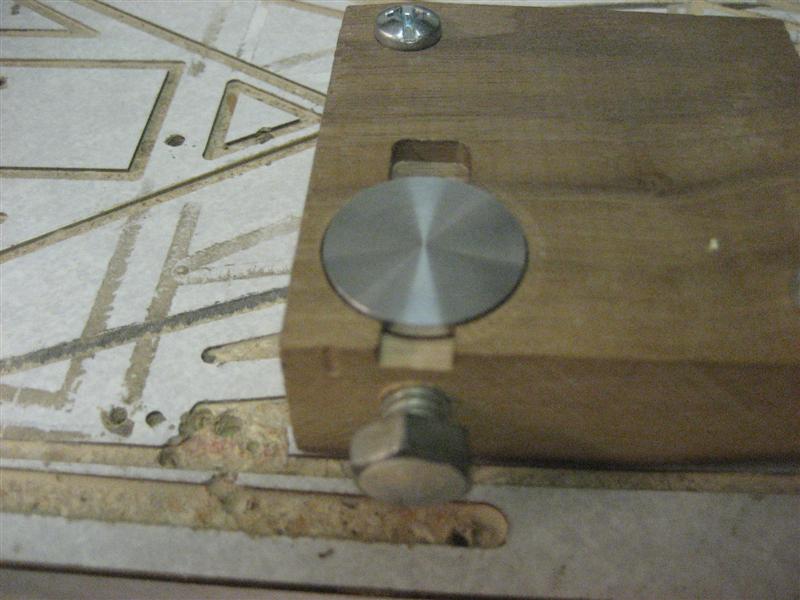

The fixture was just screwed down to a sacrifice board and machined in situation. This allowed us to use the template for the fixture as a design template for the milling program.
The turned parts were simply dropped into the fixture and then clamped in position
