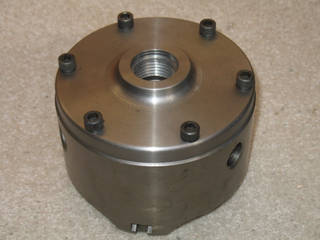

The back plate wouldn't fit the Denford, so I made one.
Mounting Taylor Chuck

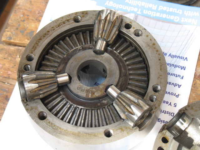

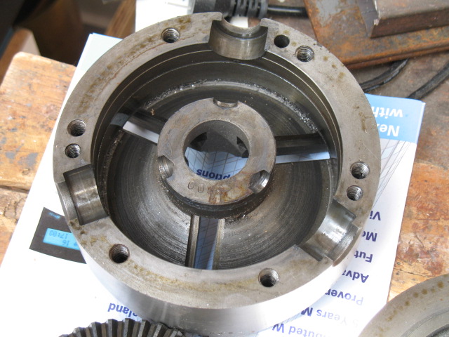

- Bevel gears drive the scroll plate.
- IMG_0874.JPG (125.99 KiB) Viewed 6504 times

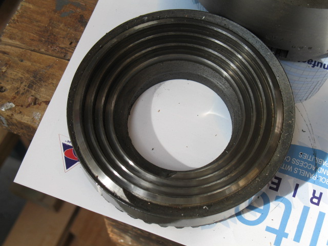

- The back plate mounts on the back half of the chuck. The chuck is split along the centre line of the bevel gears. The join line is practically invisible (accurate machining)
- IMG_0873.JPG (125.59 KiB) Viewed 6504 times

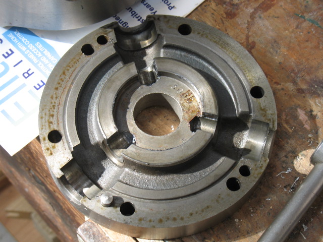

- The scroll is a dished spiral.
- IMG_0877.JPG (104.74 KiB) Viewed 6504 times
- The scroll fits within a reasonably complex casting.
- IMG_0875.JPG (121.55 KiB) Viewed 6504 times

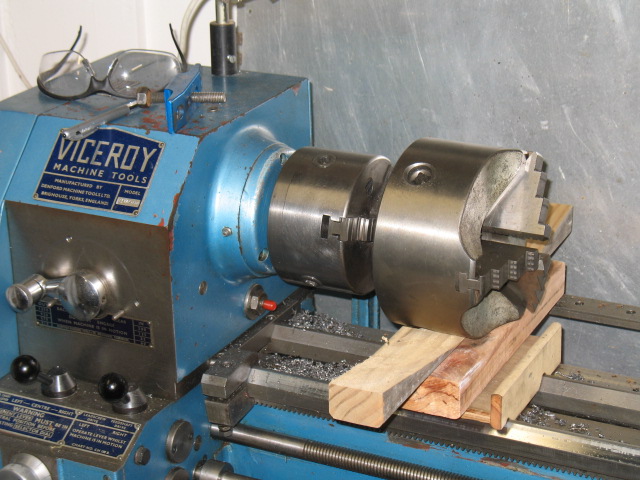

- The Taylor chuck is bigger than the standard one, but not too big.
- IMG_0853.JPG (122.87 KiB) Viewed 6504 times

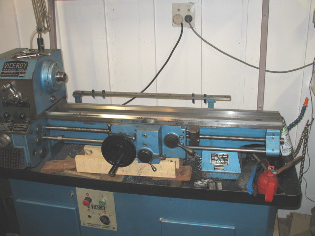

- I stripped the lathe down to clean of the cast iron dust.
- IMG_0978.JPG (84.71 KiB) Viewed 6503 times

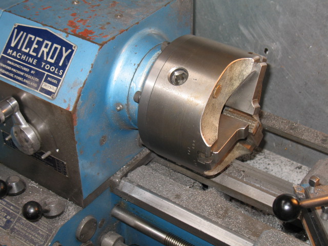

- The finished work.
- IMG_0977.JPG (123.57 KiB) Viewed 6503 times
