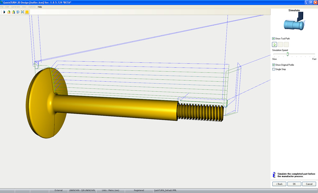

Is this the sort of thing you're making...?
I made up a few of these for Andy B to test out our latest Turning CAM software. It worked well, the biggest problem being push-off on the relatively thin shaft when threading the end so it would never come out deep enough (I decided it would be better to cut the threads by hand)

Yes, exactly that!
I'd actually do it the other way though (or I did on the last one I made manually). I turned and screwcut the end, then took down the rest of the shaft to size and shaped the rear of the buffer head.
I then parted off from the stock, reversed in the chuck to hold by the shaft and turned and faced the front of the buffer to shape.
