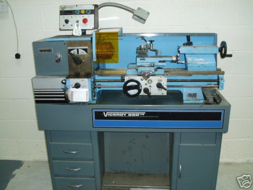

- Before...
- My lathe front view.jpg (28.72 KiB) Viewed 9037 times

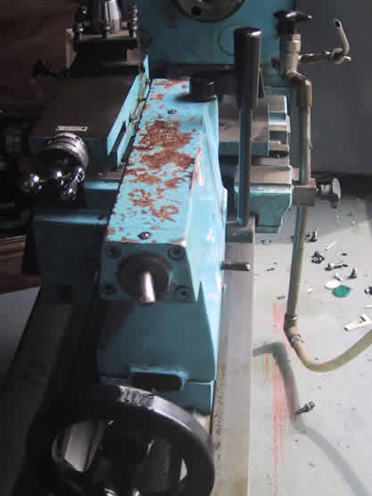

- After... tailstock
- tailstock end #1.jpg (17.24 KiB) Viewed 9037 times

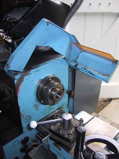

- After...the chuck guard
- chuck guard #1.jpg (19.13 KiB) Viewed 9037 times

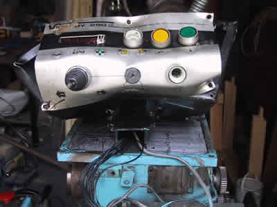

- After... the control panel
- Control Panel #1.jpg (11.08 KiB) Viewed 9037 times

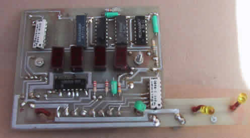

Electrically, it was a different story.
The circuit board was missing a few components and, being a bought-out item, Denford didn't have a schematic. No-one else that I could find had a board quite like mine, but through various web forums I eventually worked out the schematic, and all the components except the 7-segment displays are fairly easily available.
- Damaged circuit board
- circuit board side#1.jpg (9.85 KiB) Viewed 9036 times

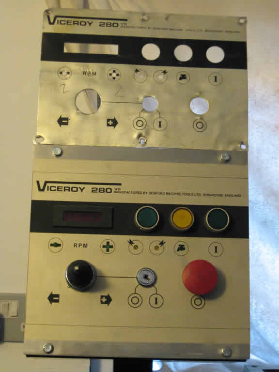

A new box for the control panel was 'found' at work. Being a different shape, the original fascia plate wouldn't fit, and was pretty tatty after being flattened out. So I measured it up and re-drew all the graphics which were printed onto a self-adhesive film and stuck onto my newly made front plate.

Sorry but I couldn't help but laugh at the state of the control box - what were they thinking

My new control box.
Yes, I can laugh at the state of the old one now too!

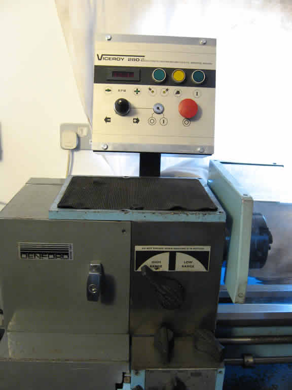

- New control box in place. Everything cleaned-up, headstock cover plate fixed back on properly (all 4 screws had been sheared through), and replacement chuck-guard fitted.
- Headstock & Control box #.jpg (21.9 KiB) Viewed 9016 times
- New panel compared to the old, flattened-out, front plate.
- New & old control panels#.jpg (24.49 KiB) Viewed 9016 times
