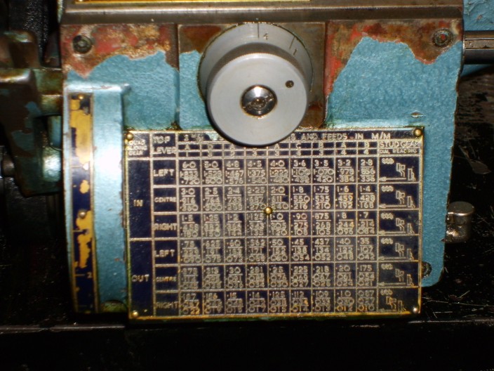

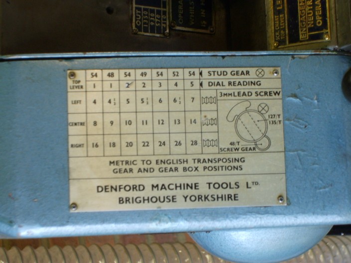

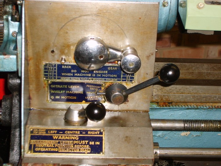

Hi everyone, just wanted to say hello and tell you about my new purchase, its a viceroy TDS 1/1 GB (Metric). After studying the manuals and all the drawings that came with it, im a little confused to say the least.
Firstly the serial number is 12914m and the leadscrew lever is on the headstock, and not on the top of the gearbox as others i have seen, so is this a very early version????.
Secondly all the other machines i have seen seem to have 5 or 8 ranges on the dial gauge and lever, mine has 4!! so according to the transposed gearing table on the machine for cutting imperial threads, 7, 14, and 28 tpi requires both dial and lever to be set at 5. am i missing something here!!

Hi, Thanks for the reply, I tooks some pics to show and it makes the old girl look a little tatty but i think its purely cosmetic, no damage to bedways apron etc so will just have to tidy her up a bit, will post more pics when in position cleaned etc.

Now the pics, please dont be too hard on me!!!!
Showing position of leadscrew lever
S6000643 (704 x 528).jpg (115.72 KiB) Viewed 14897 times
Screwcutting plate showing ratios
S6000642 (704 x 528).jpg (109.96 KiB) Viewed 14897 times

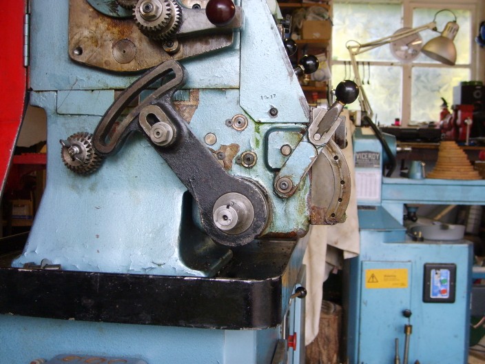

Just checking Imperial quadrant, and showing 4 notches for gears
S6000653 (704 x 528).jpg (109.53 KiB) Viewed 14897 times
Finally the ratio plate again showing the 5 speed box!!
S6000652 (704 x 528).jpg (79.39 KiB) Viewed 14897 times

I'd not noticed before, but if you look on Tony Griffiths' Denford page, there is a picture of a gearbox machine with the feed / screwcutting selection lever on the headstock, like yours is. So clearly not a 'special', it must simply be an early model.
Regarding your 4 dial positions, I can only guess that the early metric gearboxes used "1/2" of an imperial gearbox (which have 8 positions). Compared to the 5-position metric gearboxes, you are only missing a couple of threads at the 'large' end of the standard pitches:7mm, 5.5mm, so I would not have thought that this is much of a limitation for most metric usage.
Now, it could be that the ratios in the 4-position metric box left awkward gaps when using imperial transposing gears - and another guess is that the tranposing set you have (with its special guard) was supplied later, after the introduction of the 5-position boxes.

Thanks for the prompt reply, I had another tinker out in the garage tonight, fitted the imperial quadrant with a 54 spur gear and 48 drive gear, it Needs some fettling as the retaining collars for the drive gear are home made and not very well done, but all works.
Further to your question, I have checked the drive gear on the metric set and that has 66 teeth, and i have 4 metric spur gears A, B, C, and D. But also have gears with only teeth numbers marked on them and they are as follows, 21, 27, 2x48, 52, 54, and 49. Hope this helps.
Also when cutting imperial threads should the back gear be in or out, as with the metric table this does make a difference?? and the Imperial plate does not say.

PaulF wrote:Also when cutting imperial threads should the back gear be in or out....
Do you mean back gear? That usually refers to the gearing used to get lower spindle speeds.
When using the imperial conversion set, you will have removed the metric quadrant and sliding (IN/OUT) gears, and just have the transposing quadrant, stud gear, 127/135t gear pair and the 48t gear fitted on the gearbox input - so no IN/OUT to worry about. but you will need to print off a new imperial setting table, once we've worked out what it should say!

1) The number of teeth on the stud gears A-D as marked on your metric plate are not the same as the ones you have marked A-D.
From my calculations, for the 4-position box as marked on the blue plate on your lathe, the stud gears should be:
A=24t, B=21t, C=27t, D=30t
You have the first 3 anyhow, and the 30t is only needed for 5mm, 2.5mm and 1.25mm pitches. In a way it makes sense for the 'old' A to be 24t, as this is the standard stud gear for the English boxes.
2) With your transposing set, you cannot cut 6.5, 7, 13, 14, 26 & 28 tpi - which substantiates my previous theory as to why the 5-position box was introduced.
