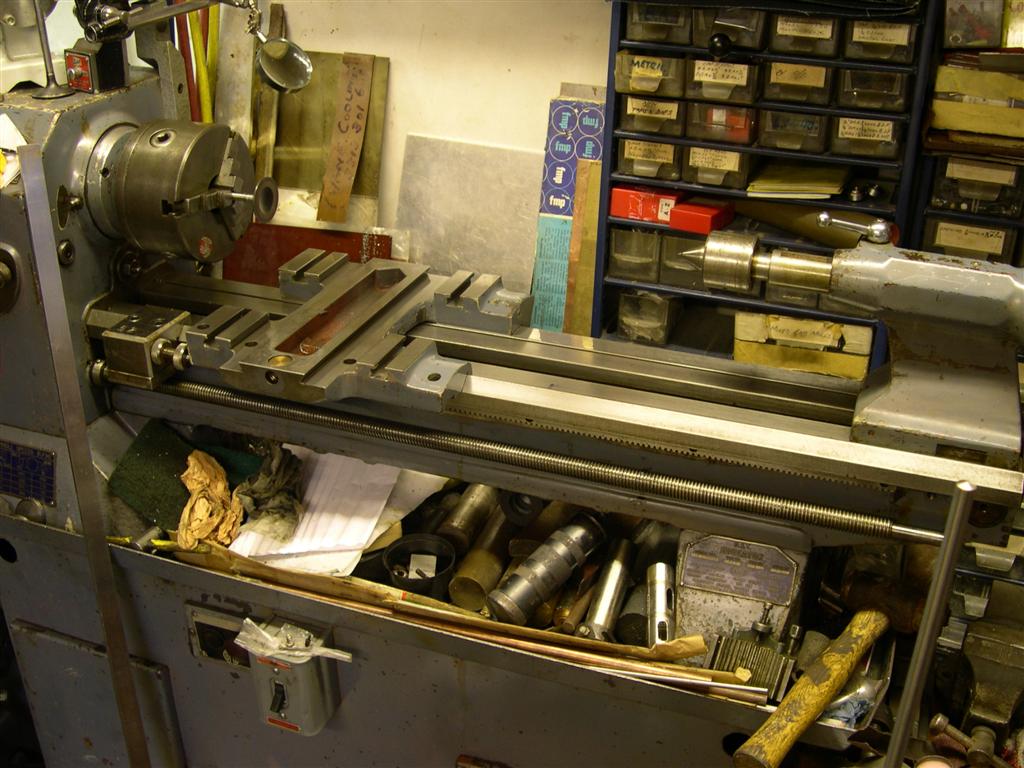

Hi all,
This site has really been an inspiration in many ways. I closely read all the TDS1 threads and Dazz’s material is really exemplary from my view, sets an incredible standard for me to try and achieve...
I bought my lathe in 2007 from a machinery dealer, and prior to this I had very little experience with these machines, either in operation or actually turning etc. But having decided I need to start doing my own work (hobby is engine tuning), read up on several types of machine of this size, I decided to set about finding a Viceroy TDS1 series machine. Having little experience at the time I took the best machine I could find at the time, I had a hot project I wanted to get on with, and so made my purchase. I really learnt what to look for having purchased this machine, but certainly don't regret it and has been a journey of discovery, some frustration but also fun. This is an early photo, when I first started to clean it up, having already cluttered it :)
Having looked at all the TDS1 literature and drawings, none to my knowledge show this 4 piece construction - head stock detaches, and separates from the headstock base, bed is separate, and the tail stock end is also supported by a bolted base.
Much of Dazz online “machine rebuild course” material has been a great help in making small improvements here and there, understanding what I need to check, and also setting up the bed straight. Interestingly the tail stock bed fixings had little effect, and after much trialling and near despair I found a method of tensioning the bed and I guess all the bolted joints and interface dovetails that did the trick. I had to trim 30 odd thou in 6 inches, and actually thought this would be difficult… I think I will need to check it frequently, as I guess it will settle over time, summer / winter changes as well, but the work I have turned has been good so I have not gone back and rechecked to fine degree for a while.
I will dig out the serial number and post up, but think it is something like 1043 ish, so I assume that is machine 43? It would be really nice to know.
Thanks for an excellent site.
