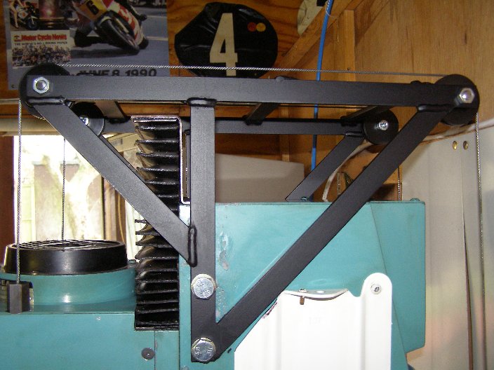

Below are a few pictures of the counter balance i have made for my Triac.
This is to ease / equal the load on the z axis stepper and ballscrew, thus reducing the chances of the stepper stalling when moving in the Z + direction.
The counter-balance weight is 20kg. This is an estimated weight of the head and motor.
- framework/pulleys

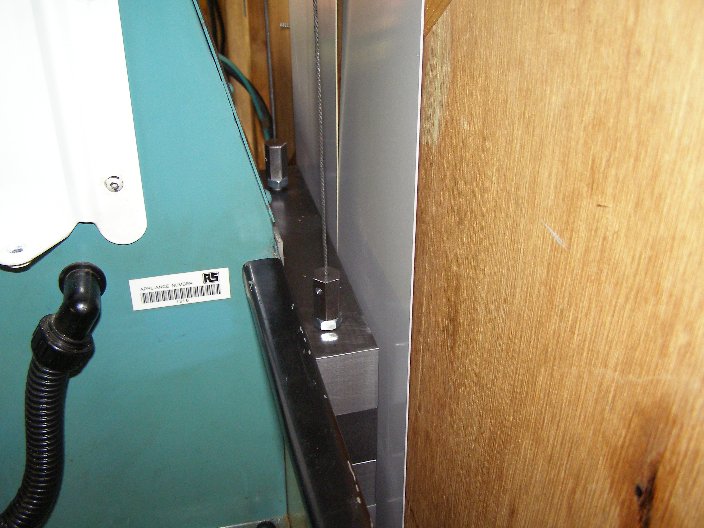

- wire attachement studs and plates
- Pc270827.jpg (58.79 KiB) Viewed 48867 times

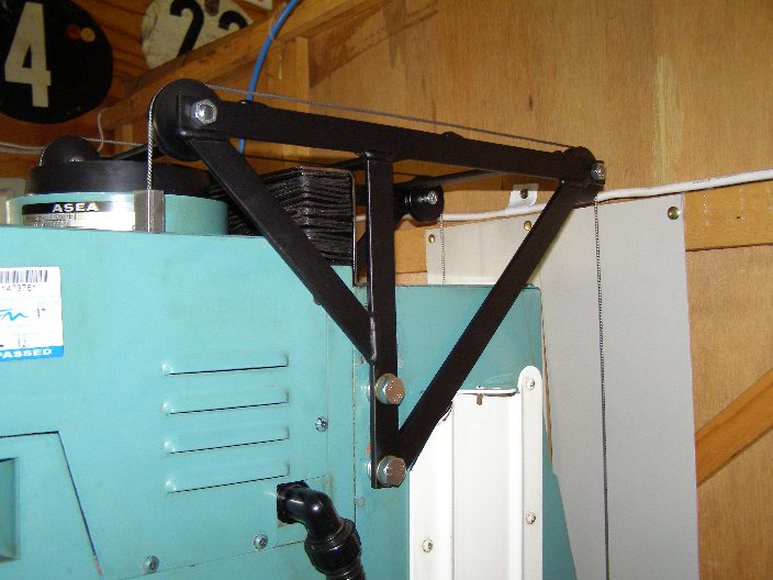

- 20 kg counter-balance weight
- Pc270828.jpg (71.26 KiB) Viewed 48867 times
- framework
- Pc270829.jpg (78.72 KiB) Viewed 48867 times

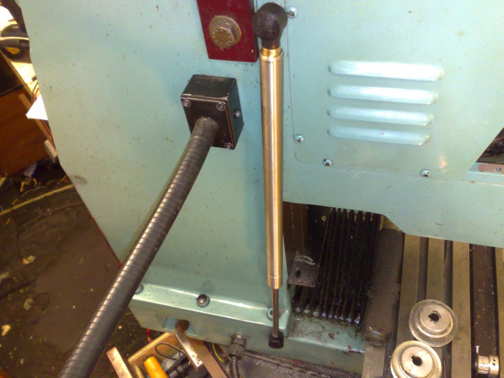

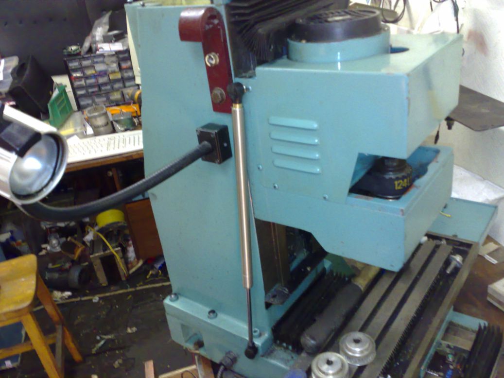

I would never thought something so simple would have worked.I got an adjustable gas spring off ebay and balanced the head perfect
(Certainly my favourite method, just for ease of fitting)
How did you balance/setup up the gas spring ?
Did you monitor motor current going up and down ?
Is average motor load higher now its having to drive(ie not drop) down as well ?
- sneakym8
- CNC Apprentice
- Posts: 46
- Joined: Tue 27 Feb , 2007 23:02 pm
- Location: northeast uk
The gas spring I bought was a stainless steel adjustable pressure spring, The pressure is at 640n when bought and you can let them down, being very careful not to go too far as you can only go down not up,
Go too far and your looking for another one.
When I first fitted the spring I disconnected the motor and the head went up
so I held the pulley at the top of the lead screw and released some gas, just a little at a time until the Z axis was in perfect balance.
The balance does not seem to alter very much at all, if the z axis is at the bottom or the top of its stroke it is still in balance.
I think that it is preferred to have the head slightly negative (pushing down)
But for the time being I left mine in perfect balance
So the motor has very low load when travelling up or down !! Good eh.

Guess I need to disconnect the gas spring...sneakym8 wrote:Hi
Dave
