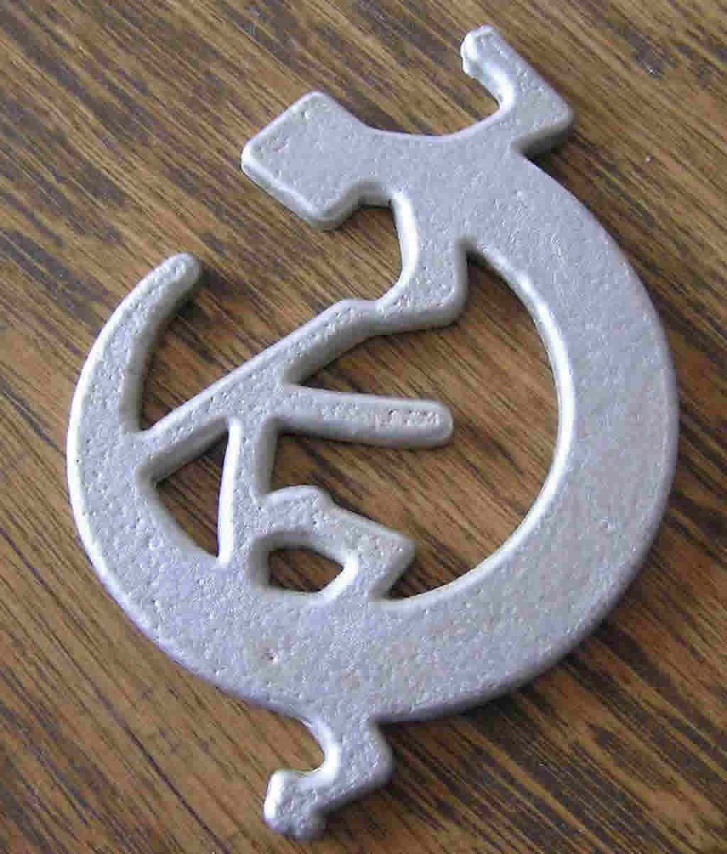

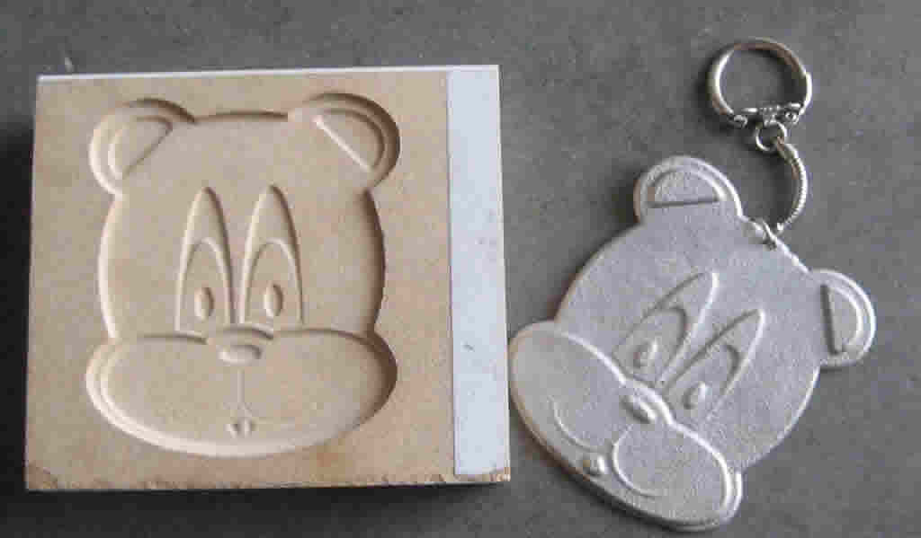

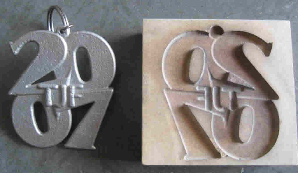

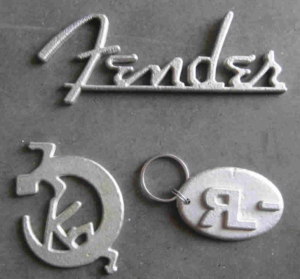

I have been running a workshop in Montana.
We have been working with several teachers and Microrouter compacts.
One of the schools in Harlem MT have been producing cast Pewter castings in MDF.
These have been designed in either Quick CAM 2D or in Pro/Desktop them QuickCAM Pro.
I attach a few pictures as curriculum ideas.
What do you think?[/img]

So the pewter is poured directly into the mdf? I assume the die is a one shot die. How far do you fill the mould? - just to the top or overflowing?
BTW whats the melting point of pewter?

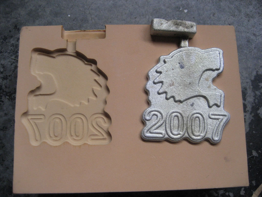

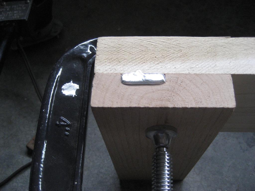

Post by Steve » Thu 09 Aug , 2007 23:41 pm
MDF can be cast into multiple times.
The ones shown have been just poured then sanded from the back.
We are cutting some more today and I will upload some images.
This time we have made a fill hole in the mould and G clamped a back on. It works great.
We have also cast into model board and the mould does not look to be marked. Could cast 20 times plus if we could afford pewter!
We are melting the stuff in a 500W lead pot.
http://www.rotometals.com/Pewter-Casting-Alloys-Babbits_c_1.
