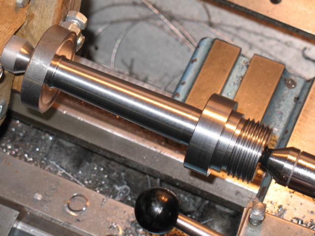

I don't have any driver dogs, so I tapped a bolt into the side of the bar. My dead center is quite long so I used a wooden spacer bolted to the driver plate. The two bolts were then wired together. Initially I didn't bother balancing the weight, but I quickly found the vibration was too high. I used three bolts and a piece of plywood to counterbalance the driver plate.

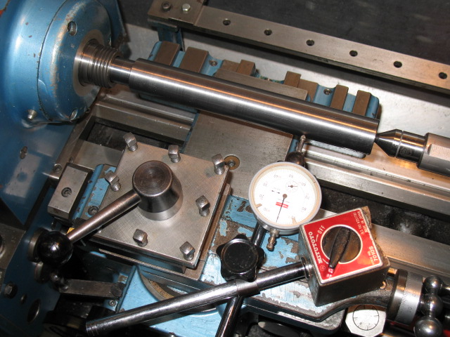

The morse taper was produced using the top slide (rather than my taper turning attachment). Setting the angle accurately was essential. I wanted to complete all turning without moving or removing the work. There was no possibility of testing the fit because of the cutting order I had chosen. I had to get it perfectly right, or accept sub-standard results. I held my parallel bar between centers and used a dial gauge on the top slide to set the correct angle. A No.3 Morse Taper is 19.922:1. This corresponds to 2.541mm/4" read from the dial gauge (I have a mix of metric and imperial tools). Getting the top-slide to precisely this angle took a while but it was worth the effort.

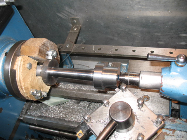

I then hogged out the basic shape of the taper spindle. I parallel cut the fat end of the taper to 23.950mm, the maximum diameter of the MT3. This made it easy to axially locate the position of the taper along the length of bar. I turned the taper to final size.

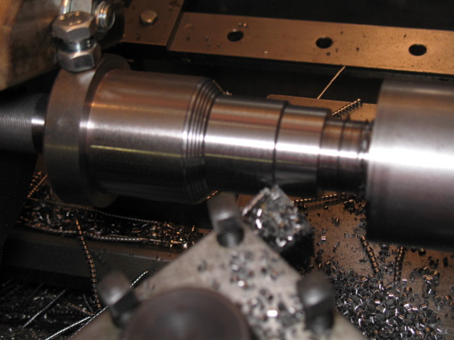

Turning progressed towards the tailstock and I finished the body and register. The nominal diameter of the register is 1.5" but the register on my lathe spindle is .0005" less than that (1.4995"). I decided to aim for the mid point and cut to 1.4997". I was able to achieve this accuracy because I still had the top slide set to the taper angle. For the final cuts, I calculated how far the top slide needed to move towards the chuck to achieve the depth of cut I was aiming for. It worked.

I cut the thread depth and profile to match the measurements of the lathe spindle making an exact copy. I don't have a go/no-go thread gauge for the spindle so trial fitting to a chuck might not have ensured that the thread was in spec and would fit all chucks. Unlike the morse taper, I could not find a spec for the thread, so I made an accurate copy of the lathe spindle thread.

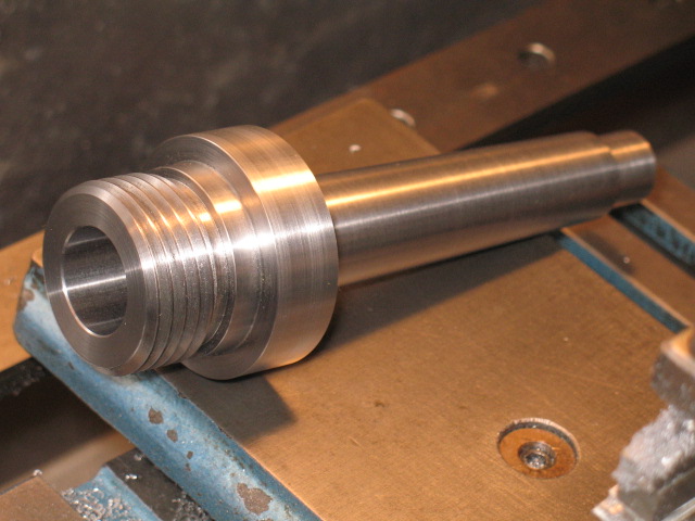

Once the thread was cut, it was time to remove the work from the lathe for the first time and try it for fit. The thread screwed into the three-jaw chuck with a good fit, but the spindle disappointingly stopped when it reached the cylindrical part of the register. After an initial burst of four-letter anglo-saxon expletives, I realised what caused the problem. The process of cutting the groove for thread tool clearance had raised a slight burr on the register. It wasn't even visible, but cutting a miniscule chamfer was enough to remove the obstruction. The threaded end and register then fitted perfectly.

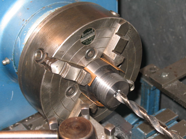

All that was left to do was to drill, then bore out the spindle nose. It all went smoothly. That completed the job. The only thing missing is something to allow a spanner to be used to unscrew the spindle. That will have to wait a while. I don't have a mill.

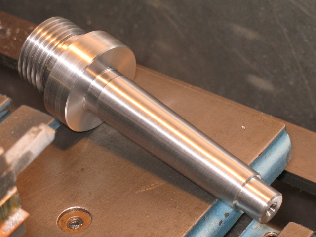

- The finished morse taper
- IMG_0773.JPG (96.02 KiB) Viewed 12891 times
- The finished threaded end
- IMG_0770.JPG (96.05 KiB) Viewed 12891 times
- The start of drilling and boring the recess.
- IMG_0766.JPG (114.17 KiB) Viewed 12891 times
- The finished taper and thread just before removal.
- IMG_0765.JPG (123.45 KiB) Viewed 12891 times
- The taper finished, now to start the register.
- IMG_0712.JPG (126.18 KiB) Viewed 12891 times
- Carbide inserts remove a lot of metal quickly.
- IMG_0704.JPG (91.65 KiB) Viewed 12891 times

Just a picture showing the use of the parallel bar and a dial gauge to set the correct angle on the top slide.
Moving the top slide exactly 4" will measure 2.541mm on the dial gauge when the angle is correct for a morse taper No.3.
Different morse taper sizes have slightly different tapers.
