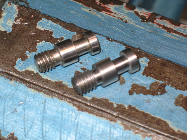

I cut my first job today. I made a copy of a missing piece to the taper turning attachment. It's made from 1215 steel. It's a small simple job but it shows the lathe does do it's job. The picture shows the original and the copy.
Things are looking better. Lathe performance is incrementally improving as I make adjustments. Using decent steel, adding bearing pre-load, tightening the belts, re-learning tool grinding, and exploring the machines limits have all helped. As time permits, I will continue to tinker with settings to extend working limits of the machine.

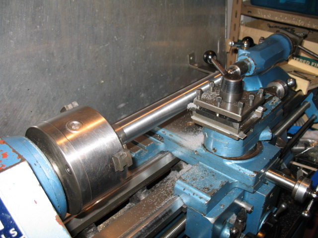

For the next test I simply withdrew the tailstock so the bar was only supported by the chuck. I mounted a finger type dial gauge on the saddle I then took a measurement at each end of the bar. I rotated the bar 180 degrees, took a measurement at each end again, then averaged the measurements at the respective ends. The 180 degree rotation and measurement averaging zeroed out any runout error as a result of the 3-jaw chuck not holding the work exactly in-line with the spindle. It was relatively easy to find the positions where 180 degree rotation produced no change on the DTI.
This test took a few goes to get consistent results until I mounted the DTI on the saddle rather than the cross slide. The measurements showed that over a distance of 250mm, the free end had an error of 2 thou inches away from the tool. This means that the spindle is not quite lined up with the bed. This is a small error over a relatively long distance. It doesn't take much of a force on the end of the bar to produce a 2 thou displacement. The weak link is the three jaw chuck.
I am not too worried about this error. There is no way that I would attempt to turn anything 250mm unsupported from the chuck. Tool forces would create much greater errors than 2 thou. So in practice, I think this error is immaterial.
Applying a few kilograms pull to the tailstock (with centre withdrawn from the bar) corrected the error. This force was enough to twist the bed to bring the bar end closer to the tool. As an exercise in pedantic perfectionism, could this error be eliminated by adjusting one of the bed mounting bolts to twist (untwist) the bed. Is this a technically "correct" method of eliminating this type of error.

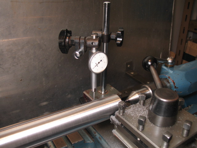

The images below show the bar being cut. The other shows the finger indicator being used to measure runout at the free end of the bar.
So these and the previous measurements show that the lathe is still accurate and nothing is bent. The small twist in the bed is insignificant compared to tool force displacement errors. The only other test that I think I could do would be to face the surface of a large disk. This would check the accuracy of the cross slide. I have a surface plate, but I don't have any suitable steel for a test piece, so I won't be doing this.
