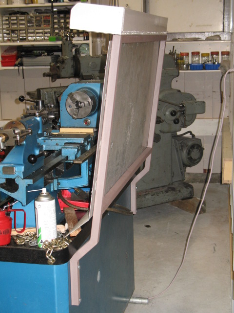

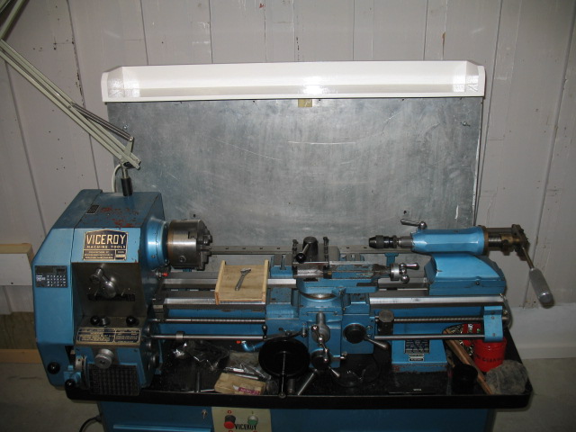

Just a small welding project for my TDS lathe. The lathe came with a splash panel that was hung off the brackets for the taper attachment. For a number of reasons, I decided that this was unsatisfactory. This included not having a convenient shelf to place items.
I made a frame for the aluminum panel. The panel is held on with wing nuts. This is so I can remove the panel easily to allow me to swap cross slides. I have a Tee slot cross slide as well as a standard one.
The frame includes a shelf for handy tool stowage. The shelf intentionally slopes to prevent any chance of items vibrating off the shelf.
The frame is bolted to the base.
Front view of the new splash guard and shelf.
The shelf slopes to keep items on the shelf.
