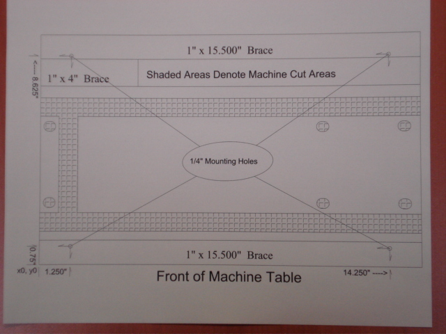

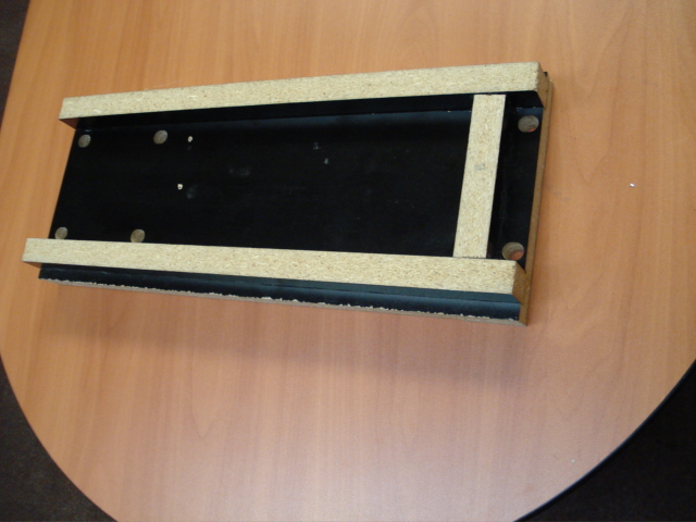

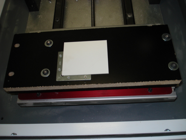

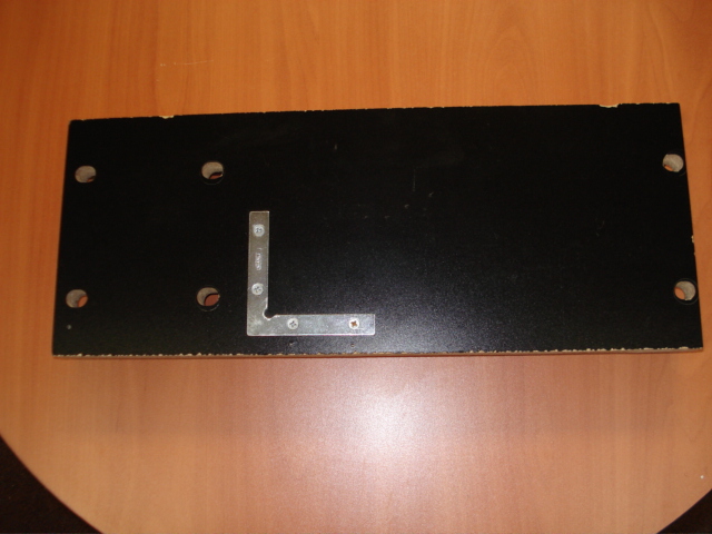

We made a plate that attaches to the Denford Co2 car fixture.
You don't have to remove the fixture when switching to litho's.
Attached are photos, basic instructions and the .fnc file for use with the Compact 1000 or other Denford routers.
Plan View.JPG (140.04 KiB) Viewed 4425 times
