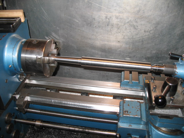

Without really planning to, I have ended up making a parallel test bar. When I was testing the lathe, I found that the headstock wasn't quite lined up with the tailstock. Tests showed 2 thou" error. I decided I'd have a go to see if I could eliminate this error just to see if I could do it.
To do this, I held a 35mm bar in the 3-jaw chuck, and the other end in the tailstock centre. I adjusted the lateral setting of the tailstock until I was able to turn the bar parallel.
With a dial gauge on the tailstock end of the work, I then released the tailstock centre from the work. If the spindle is perfectly lined up with the tailstock, the dial gauge doesn't move.
The reality is that the dial gauge will always move because the 3-jaw chuck will not hold the work in-line with the spindle. To eliminate this error so I could see the error between the spindle and tailstock alignment, I did the following procedure.
I measured the min and max deflection with the DTI at the free end of the work, then rotated the work until the DTI read half-way between the min and max. This can be checked by rotating the chuck 180 degrees. It should end up with the same reading. In these two positions, the work and the spindle line up when looking down from above the work.
If the tailstock centre is now engaged with the work, any movement of the DTI indicates misalignment between the spindle and the tailstock.
I corrected this by adjusting one of the four bolts that hold the bed to the base. I nominated one (shouldn't matter which) as the only one I would touch. The bolts are obviously designed to be adjusted. There is a large brass adjustment bolt that has a steel holding-down bolt passing through the centre. Turning the brass bolt adjusts the height of each bed foot.
Adjusting the lathe bed alignment moves the tailstock out of alignment. So any adjustment to the bed requires more test cuts to line up the tailstock. The adjustments were itterative and it took me a day to narrow down the errors.

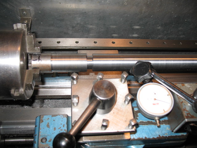

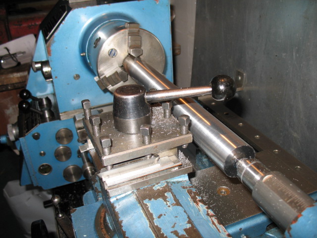

It was at this point that I decided the bar was going to end up too valuable in terms of my time to recycle. So I decided to make a parallel test bar with a morse taper at one end. To do this, I re-mounted the bar in the chuck. I cut a grove to a depth that matches the fat end of a morse taper. I then did a parallel cut and took a series of measurements along it's length. Every point measured 1.2493" (I was aiming for 1.25" but overshot). My test bar is straight and parallel to within +/-0.05 thou" (50 micro inches) over a 9" length. At the start of this little project I didn't know how much I could reduce the errors, but the results are far better than I ever expected to achieve. This little lathe is impressively accurate.

Hold the micrometer the same way when measuring. I got different measurements if the micro was horizontal or vertical. I did all measurements with the micro held vertically.
I measured every point three times to ensure I was getting consistent results with the micro. It's easy to get within a thou ". My micro has a vernier scale for 0.1 thou" and I found good technique was essential to get consistent measurements.

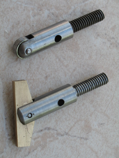

I am planning a couple of little project with morse tapers. I intended to use the taper turning attachment. This comes with a roller follower which runs along a straight edge. The straight edge is set to the angle of the taper. The roller follower would be great for copying curved shapes. For straight tapers, any eccentricity of the roller, dirt or marks on the straight edge would appear on the work. I decided to make a skate to get smoother results.
The result is shown in the image. I used brass to avoid wearing the steel straight edge. The brass skate is hinged on a roller bearing from a racing kart engine that I blew up (another story). The brass has square ends to push away any dirt or swarf on the straight edge. It should smooth out any minute bumps on the straight edge.

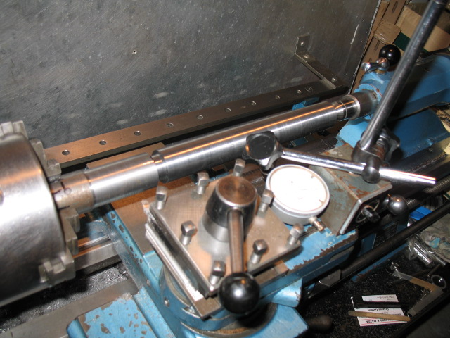

The hard part is setting the taper angle. For 4" travel, I need 0.1" offset. The photos show a DTI mounted on the top slide. I am using my parallel test bar to measure and set the right angle on the top slide. The parallet test bar provides the reference I need to get the morse taper right.
Setting the correct angle is going to take a bit of effort. Tightening the top slide clamping screws rotates it a little, so it's back to the measure, loosen, adjust, tighten, measure cycle. I have found that it helps to tighten and loosen the screws in the same order.

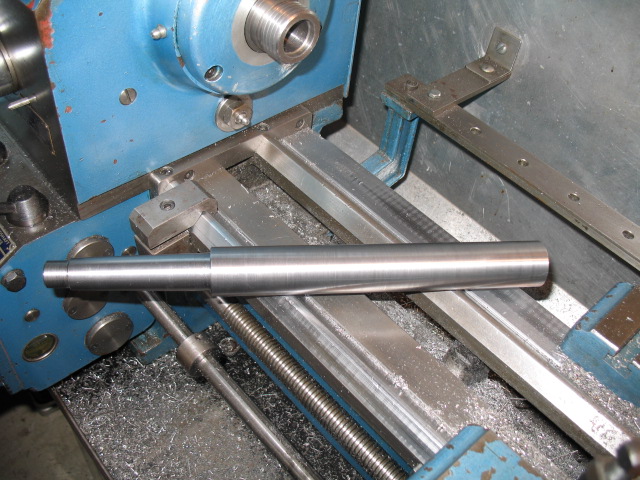

So at the end of this exercise, I have a very accurate lathe and a test piece to prove it. The parallel bar is already proving useful to help set up the morse taper. Knowing how accurate the bar is will make it a useful reference and accessory to help make other projects. I have learnt a lot while making this simple bar, mostly about how good the lathe is.

- This image shows the original roller form follower supplied with the taper turning attachment, and the brass skate I made.

- Showing cutting of the test bar to measure errors on the work and then make adjustments to the lathe. I have long lost count of how many test cuts I have completed.
- IMG_0544.JPG (118.36 KiB) Viewed 10982 times
- Showing the parallel test bar with a groove cut to locate the fat end of the morse taper. The depth matches the fat end diameter. The DTI is mounted on the top slide and measuring offset from the parallel bar.

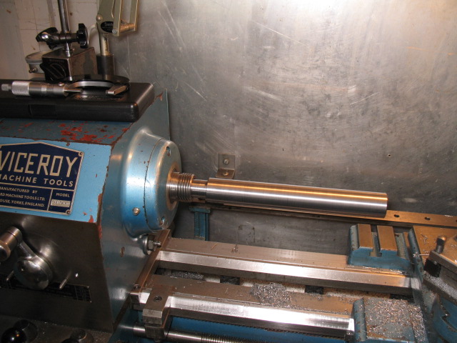

Just a shot showing the finished morse taper before flipping over to machine off the metal that the jaws are gripping.
All the effort to set up the morse angle paid off. It's a good tight fit.

- The bar fitted to the spindle.
- IMG_0621.JPG (112.63 KiB) Viewed 10934 times
- The finished bar.
- IMG_0622.JPG (141.25 KiB) Viewed 10934 times
