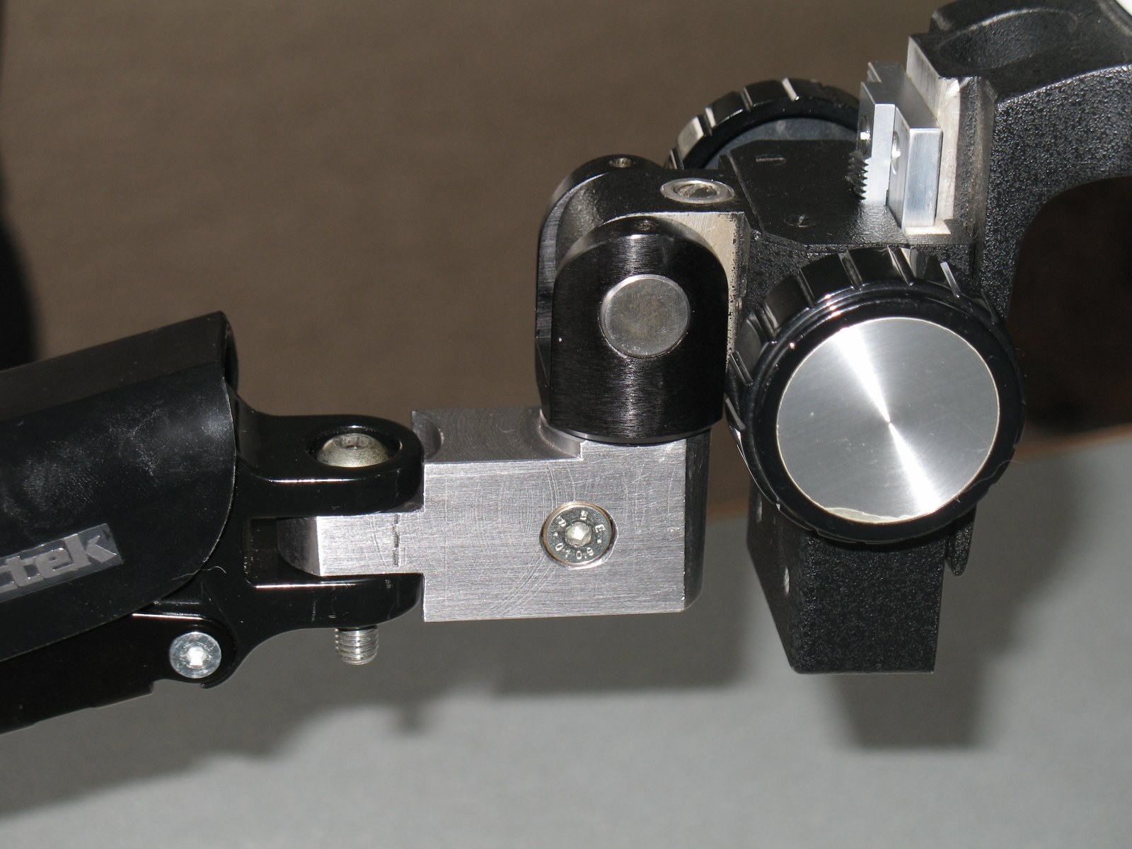

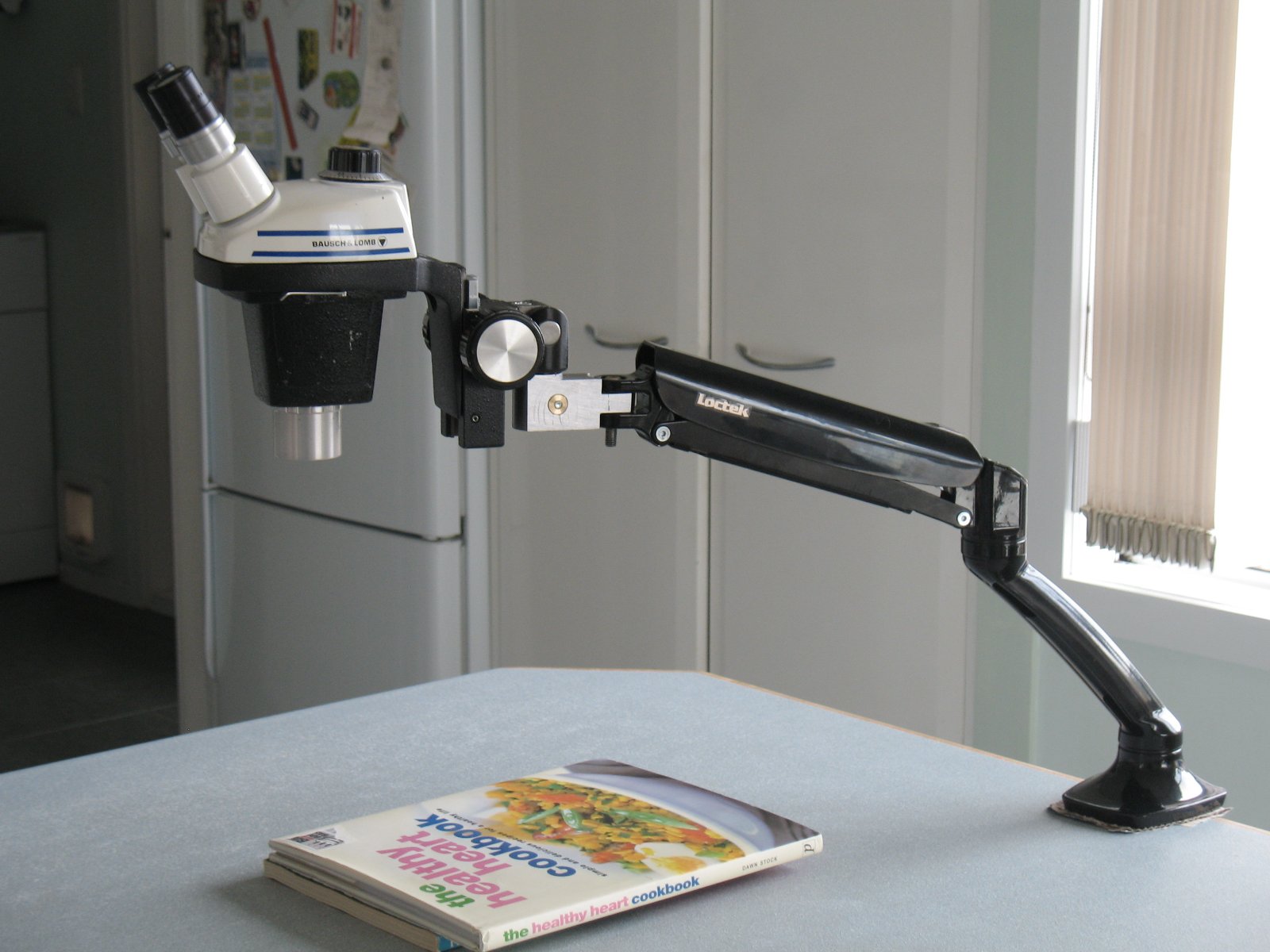

I purchased a Bausch & Lomb Stereo Zoom 4 microscope from ebay USA. This is for electronics, which use parts small enough to require a microscope to work with.
To reduce shipping cost, I found a microscope with a mount but no stand. The plan was to buy a computer monitor stand and make an adapter.
Although some surfaces were machined on a mill, most operations were completed on the lathe.
Microscope adapter

- A close up of the adapter
- IMG_0929.JPG (237.95 KiB) Viewed 39897 times
- The complete monitor stand, adapter and microscope
- IMG_0926.JPG (193.05 KiB) Viewed 39897 times

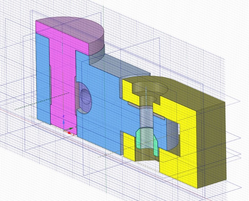

A CAD view of the adapter.

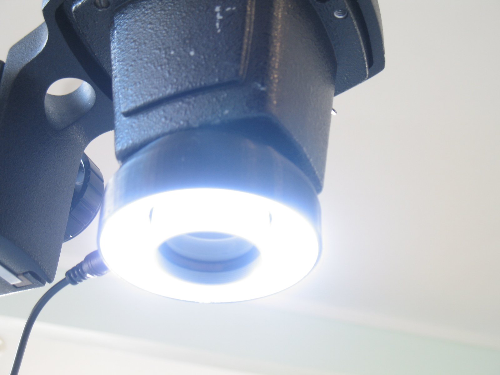

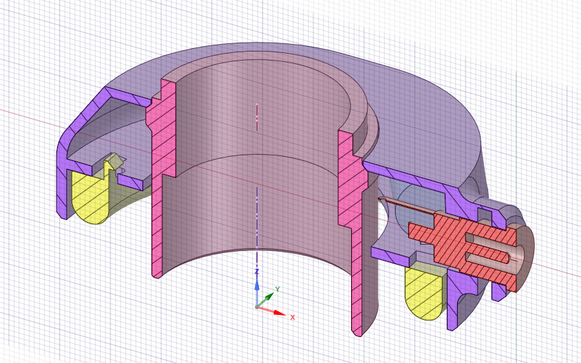

I also made a ring light 3D printed. Not done on a lathe but I thought would be of interest.

- LED Ring Light X sect.png (497.64 KiB) Viewed 28960 times
- IMG_0993.JPG (134.28 KiB) Viewed 28960 times
- SZ4 Adapter Cross Section a.jpg (139.18 KiB) Viewed 28960 times
