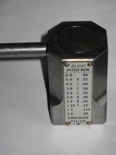

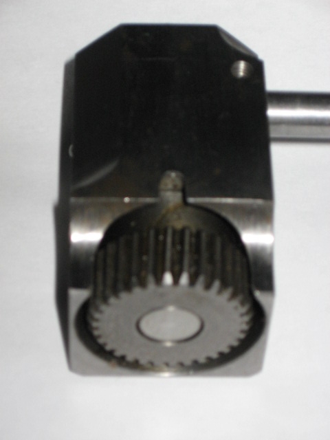

The gear on my metric one has 30 teeth and, as you can hopefully see in the attached pix, it covers a wide range of metric threads.

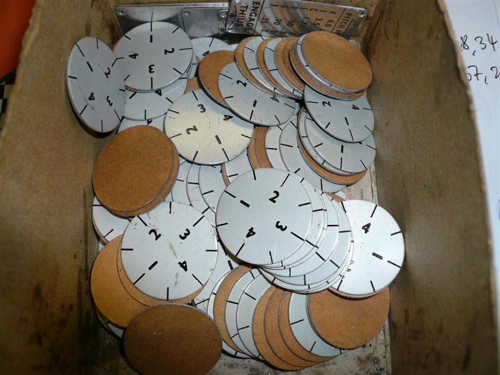

My picture doesn't really show that there is only one line on the top of the metric indicator - i.e. there is only one position in which it should be engaged, rather than multiple positions that can be used on imperial indicators. If you want some better pictures, PM me with your email address - I did those very quickly just to get you going.

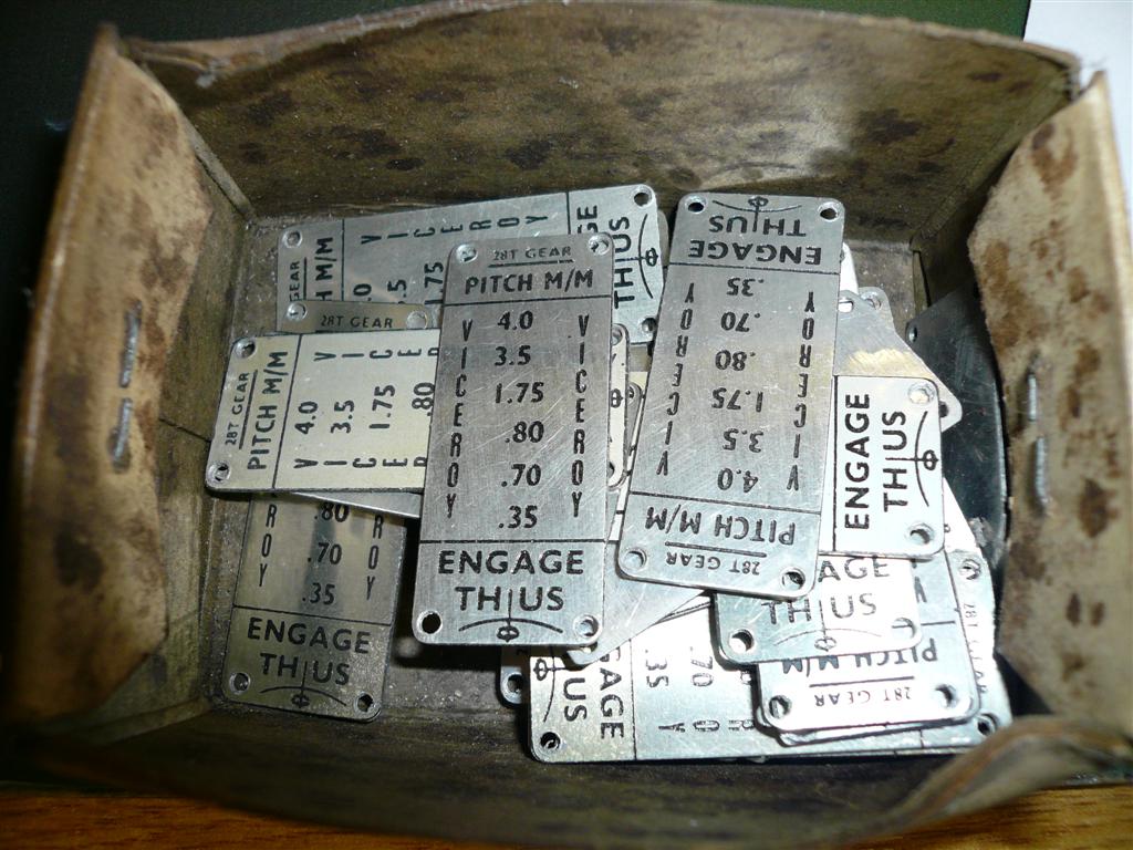

At the far end of the old DO (where the old copier is), on the floor next to the cupboard in the corner, was a box with various old charts/plates in. I know there were some english top indicators (CH246), and I think there were some metric front plates as seen in my picture.
Baldrik - looks as though all the info you need for the gears is on the drawing. If you decide to make a 28T as well, could you make 2 and sell me the other?

Hello AdminDenford Admin wrote:Box full of mm ones - can't find any english (unless I'm looking for the wrong thing?)
PM me your address if you want one posting
I am making a couple of Dial Thread Counters for Metric Threads, Could you post me a couple of 30 tooth and 28 tooth information plates as shown in your photo showing a box of them?
I will PM my postal address.

I have made a couple of 28T gears to fit my Viceroy TDS 1/1 GB (Metric) Dial Thread Indicator, as per original specifications and made from Meehanite Cast Iron as per original. I have tested them and they work perfectly, engaging accurately and allowing the counter to be used for the other metric threads e.g. 1.75 thread (12mm) etc. With the spacing collar the right length, it engages exactly on the marked line.
