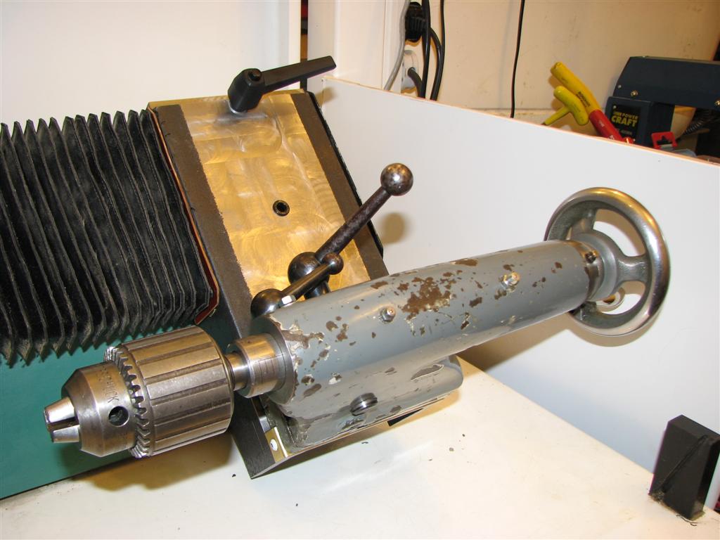

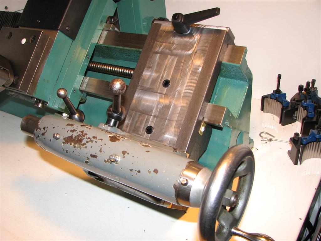

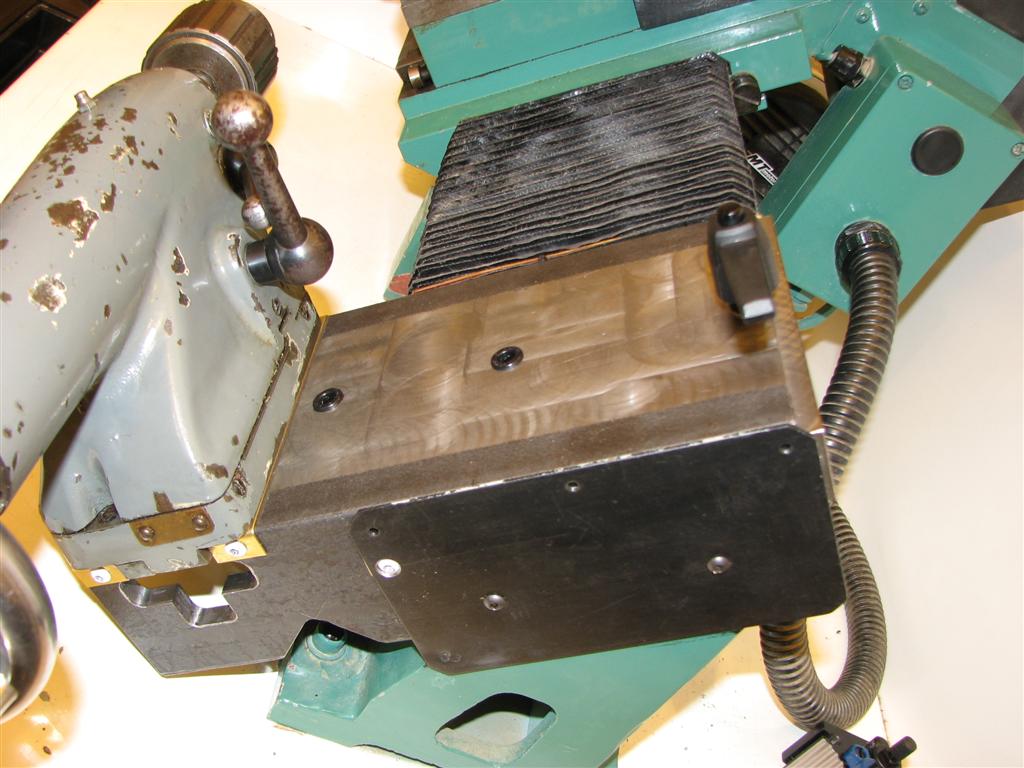

Finally I tidied up my drawings for the Myford tailstock adaptor to fit a Mirac PC.
Attached are drawing files and photographs.
You may notice that I fitted some captive brass shims where the tailstock sits on the adaptor this was to finally achieve correct centre alignment. Without this the machining would be much more dificult as I had to measure Mirac centre heights etc. Also this allows for variations that may be present as not all Myford tailstocks may be dimensionally identical (wear and re-scraping/grinding etc.)
Hopefully this will provid eneough info to inspire you to build your own. I can answer specific queries if you have them.

- End view of adaptor in position with Mirac bed end cover replaced.
- IMG_2349.JPG (104.77 KiB) Viewed 4623 times
- General view of adaptor and tailstock fitted.
- IMG_2347.JPG (93.46 KiB) Viewed 4623 times
- View showing adaptor in position without Mirac bed end plate in place
- IMG_2344.JPG (98.55 KiB) Viewed 4623 times
