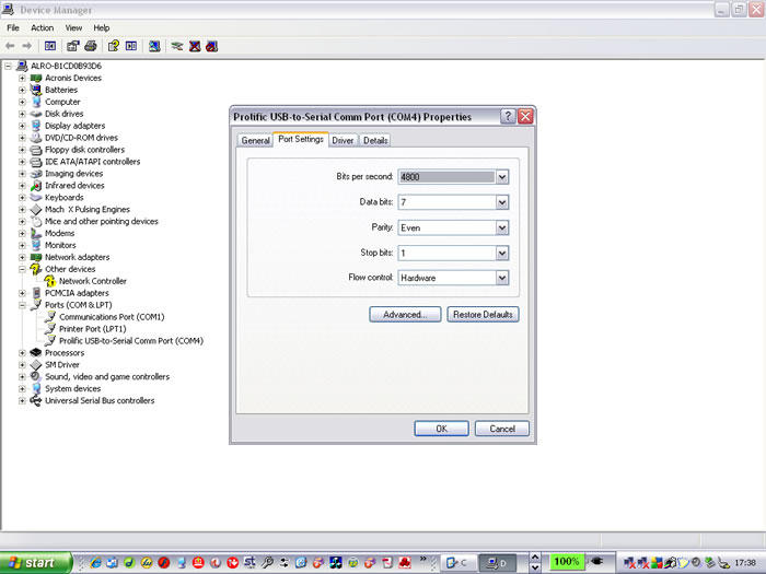

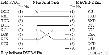

Here is the diagram of pin connections that I use for my RS232 cable, it is used on Denford Cyclone lathes with Fanuc OTB and OTC controls, also the same cable is used on a Bridgeport VMC with Fanuc OM - Mate control and I have no problems whatsoever using it with a USB to Serial adapter to an IBM Laptop and an IBM PC
All settings on the DNC and the PC Comm Port should be set to the "Hardware" settings for best results!!
Everything shown below works on all Fanuc O (T or M) controls I have ever used.
Serial-USB settings.jpg (52.18 KiB) Viewed 11452 times
