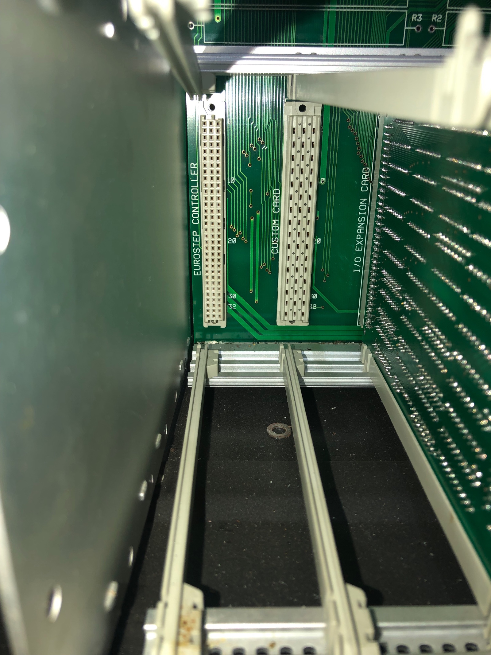

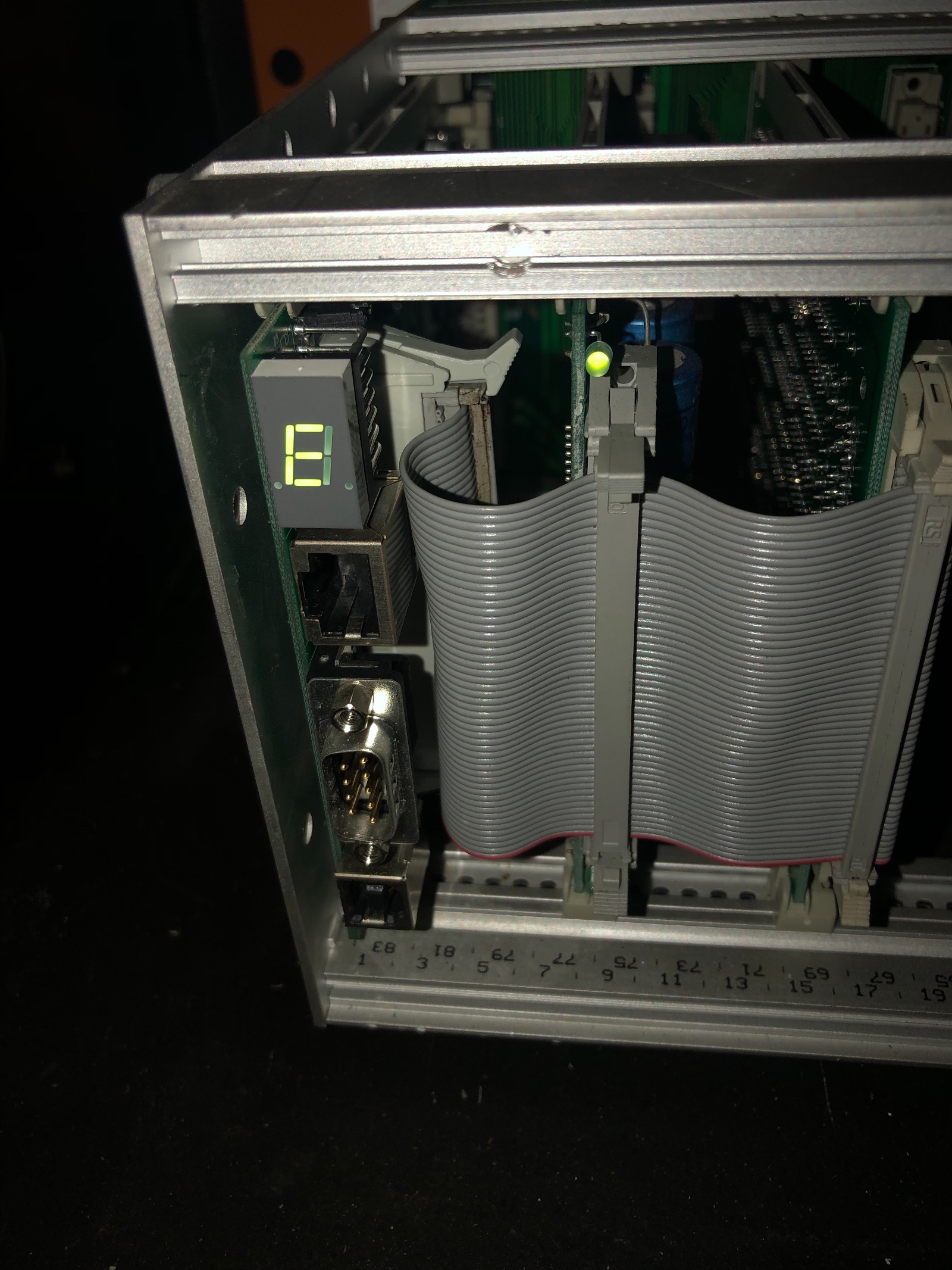

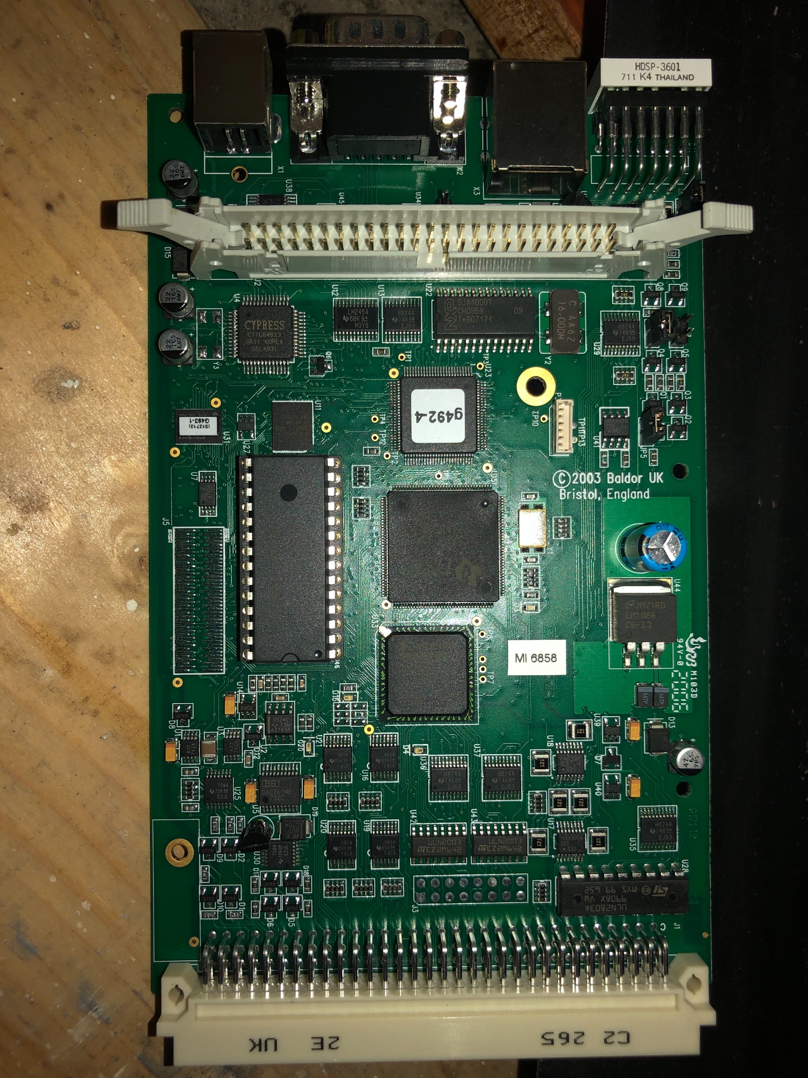

Has the machine been upgrade?
If you post a picture of the control card & EPROM we can guide you through what it was supplied with & what is required.

The machine is running a Eurostep controller card and has been USB upgraded at some point.
I have tried to identify the EPROM but may be missing something, as the boards do not look like any I’ve seen on other posts…

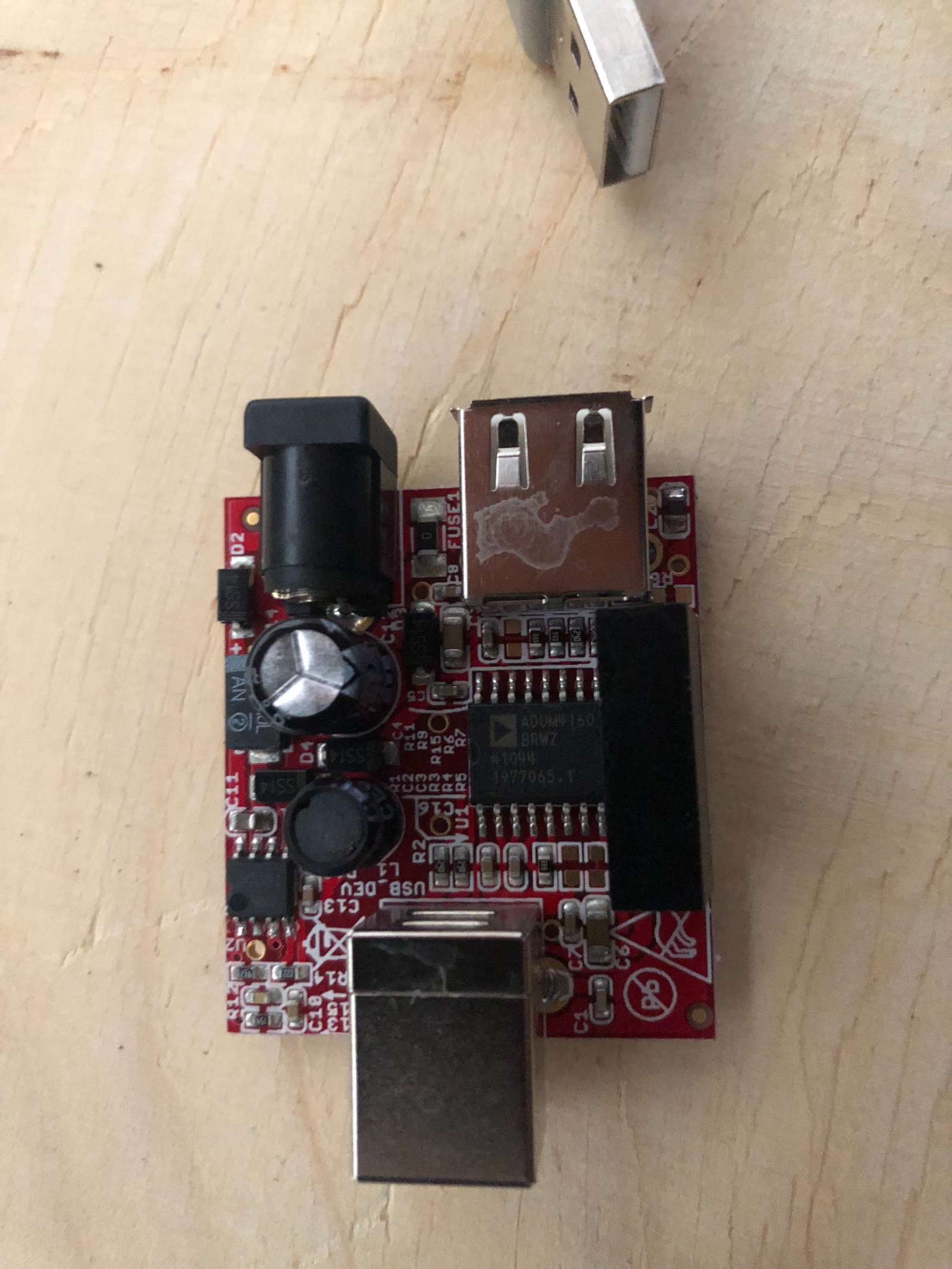

There is a USB lead coming from the MINT card, to a small device, and it looks like it is missing a 8-15v dc power supply, I assume 12v, I’m wondering if this device is common/needed to power the usb to the pc.
The led cycles through, spelling PESto… of PE5to… maybe this means something to someone?!

The PCB is a USB isolator & does not require a power supply. It protects the control card if the spindle motor flashes over.

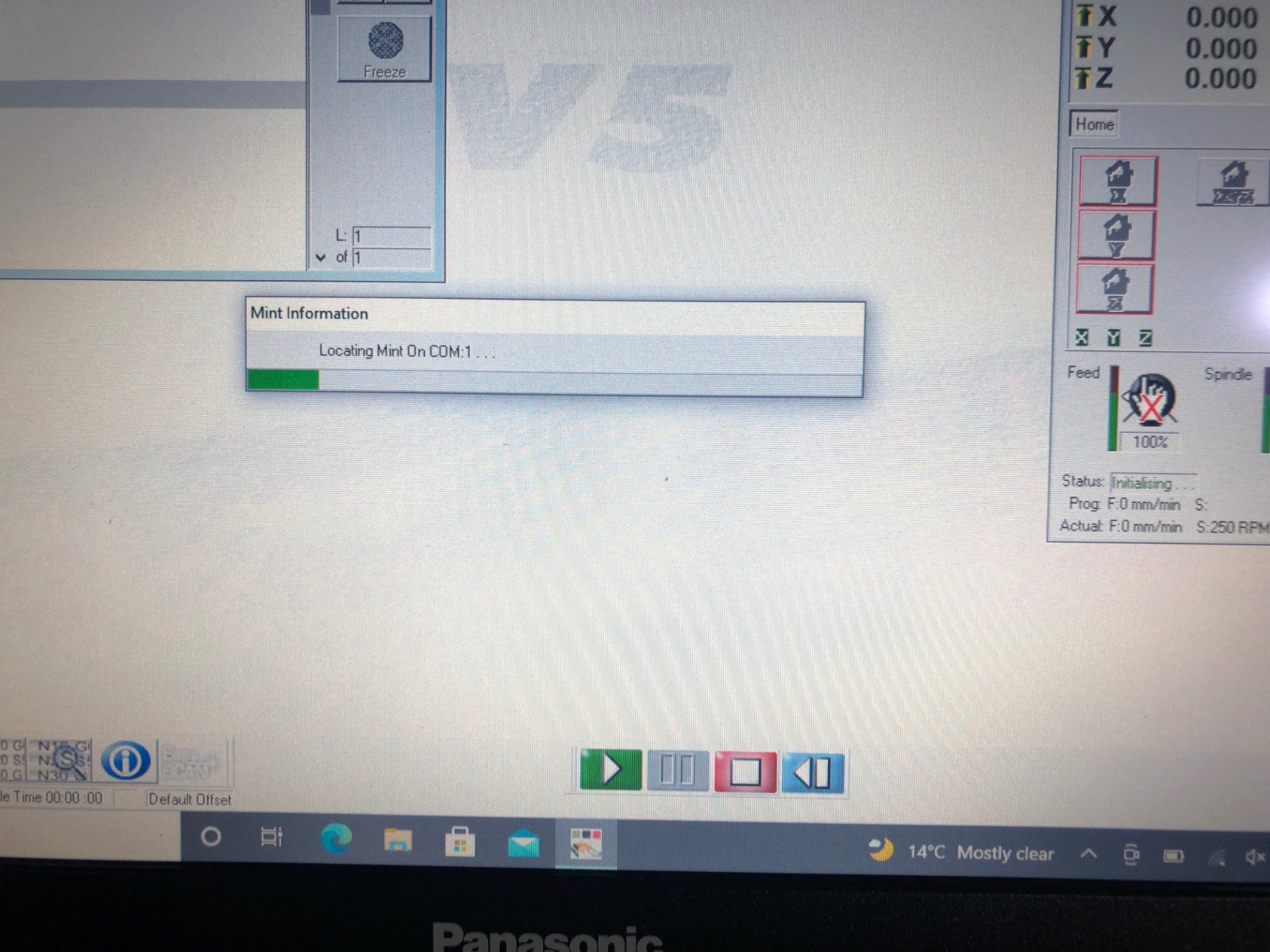

It seems the ‘device’ is essentially a surge protector for the PC.
(Unless someone can correct me!)
Tried with a 12v psu, but no difference in connecting.
Have run through the machine types and getting closer…
Looks like it maybe a pc issue now?
Need to make a usb look like the com1 port…? Maybe!

Re: QuickCAM License Cost
