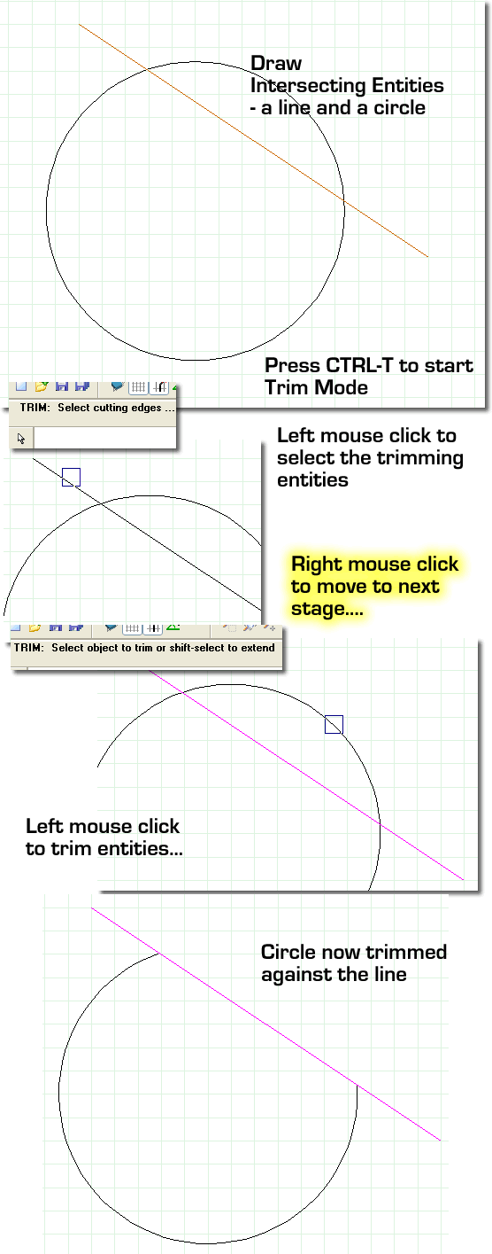

While the combine outline works well for most shape editing is it possible to trim lines? If so how?
There is a "hidden" feature in QuickCAM 2D and LaserCAM 2D which allows you to trim simple features.
(This feature is not documented or tested, so there are no guarantees!)
Press CTRL-T to start trim mode
Left mouse click to select trimming edges (eg the line)
Right mouse click to move to the next stage..
Left mouse click to select the object(s) to trim
See attached example of the trim in action

- Hidden trim feature of QuickCAM 2D
- quickcam-trim-mode.gif (48.57 KiB) Viewed 25490 times
