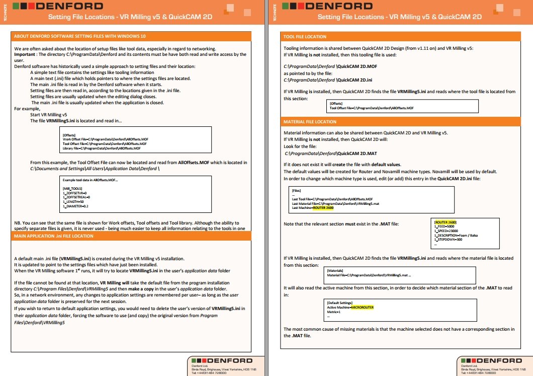

Post by Denford Admin » Mon 16 Aug , 2010 16:19 pm
How VR Milling and QuickCAM 2D locates the tool and material setting files...
eg:
VRMilling5.ini
QuickCAM 2D.ini
QuickCAM 2D.MOF
QuickCAM 2D.MAT
V5 Milling - Setting File locations.jpg (168.5 KiB) Viewed 14569 times
Download as a PDF here:
V5 Milling - Setting File locations.pdf
(338.51 KiB) Downloaded 1149 times
