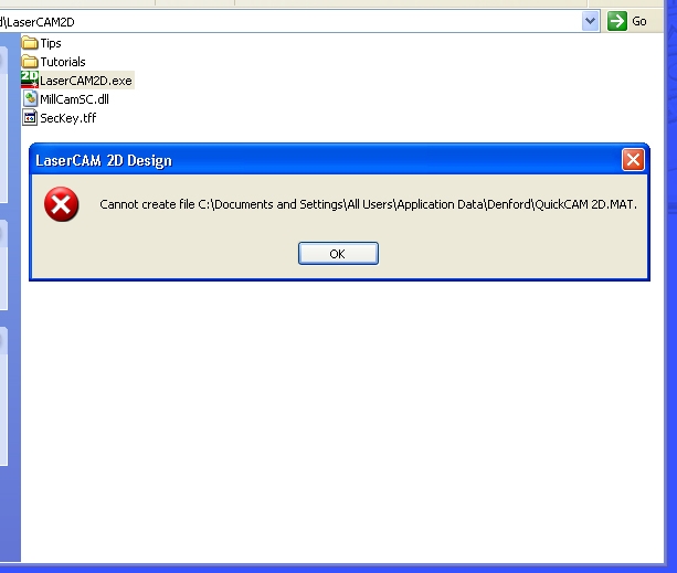

When I try and install LaserCam 2D as administrator, I get the following Error Message

If you install LaserCam on a clean PC you get the error as stated.
By installing QuickCam2D the relevent files/changes are added & LaserCam will then work OK.
Post by Denford Admin » Tue 19 Jun , 2007 17:02 pm
Try the latest version:
viewtopic.php?t=1020
This has hopefully fixed the issue
